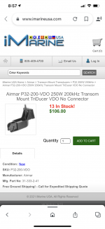

ok so there is NO part number for the transducer by airmar but I’m under the suspicion that it is the Airmar P32-200-VDO as attached. It amazes me here that NOBODY has had to replace a speedometer wheel/depth transducer here for a 99’ VDO interceptor but oh well. I’m going to order it and attempt to install it and will post what happens for future reference.

ok so there is NO part number for the transducer by airmar but I’m under the suspicion that It amazes me here that NOBODY has had to replace a speedometer wheel/depth transducer here for a 99’ VDO interceptor but oh well.
Paddle wheel speedometers are notoriously inaccurate and went the way of the dinosaur when GPS speedometers went main stream 20 years ago.

True, but I’d like to find one that fits the current system. I believe I have I need to call Airmar and ask them directly. P23-VDO-2000 looks exactly like the broken one that is hanging from the back of my boat without the speedometer wheel. I’ll post if this works if I ever get a chance to talk with them.
Are you sure that assembly went to the speedometer?
Upon closer inspection it looks like a transducer with a paddle wheel.
Are you sure there wasn’t a fish finder onboard at one time?
How many pins in the connector?
Be easier and probably cheap to just replace with a GPS Speedo of the same size.
