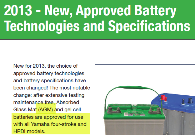

Yamaha seems to think that the F115 is compatible with AGM lead acid batteries. Been approved by Yamaha since 2013. Many folks were using AGM lead acid batteries with Yamaha motors long before Yamaha "approved" them.
Not sure how that relates to model that is 12 years older. (2001)
Even if true, I take issue with purposely over charging an expensive battery in direct violation of a battery's warranty Terms and Conditions.
The advertised output of the F115 is 15.0 V
AGM batteries are designed for use with AGM battery chargers with a MAXIMUM output voltage of 2.4 volts per cell(14.4v for 12v batteries and 19.2v for 16v batteries). AT NO TIME during charging should the battery be subjected to more than 2.4 volts per cell. Improper charging can cause damage that is permanent and WILL VOID THE WARRANTY.
The same doesn't hold true for the larger outboards (F150 and up) that have 14.5V outputs.
It relates because Yamaha says that the electrical generation system of the F115 is compatible with an AGM lead acid battery. The age is irrelevant.
I don’t care what they say…tell that to the AGM manufacturer that denies your warranty claim when they point out the use of a 15V charging system.
No thanks… been there done that. At the end of the day AGM buys you nothing but a lighter wallet anyway
