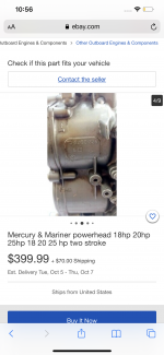

Maine, I found a used powerhead but not sure if it will work, it’s not a mercosil block but the guy said it will fit a 25 Mercury. Has very similar part number.
Aneddeau25
Sep 28, 2021
5
This is the used one for sale. And my part number is 872-9076-c14

Rebuild it yourself. The kits and the manual are available. The hard part might be finding a shop that can do a blind Mercosil Bore.
Aneddeau25
Sep 28, 2021
5
I just may have to but the kit is 400$ and so is the powerhead I found it looks like it will match up. Just the last numbers has me a bit worried.
Faztbullet
Mar 2, 2008
15,938
That used one is a chrome bore and they scuff as bad a s the Merosil block. Make sure seller guarantees compression and sends you pics of cylinder walls
Honorary Supreme Mariner
39,984
Very easy to remove bypass covers to inspect condition of motor.
