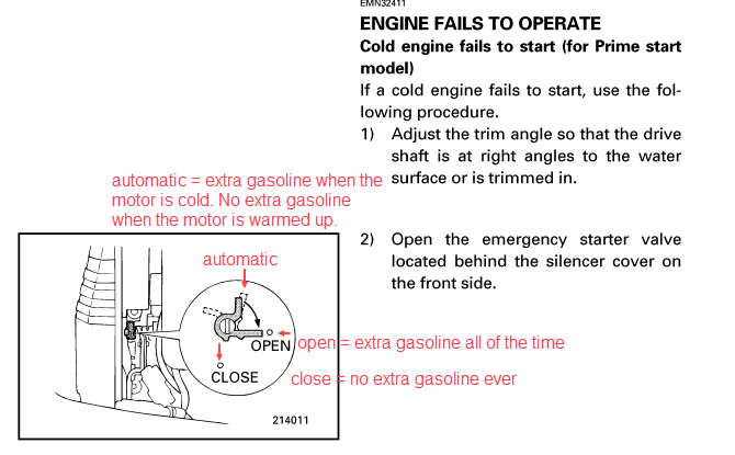

99yam40
Sep 7, 2008
9,370
prime start system is not a choke.
but like you said in normal it should add extra fuel when motor is cold and then close off the extra fuel as the motor warms up.
if it will only run properly in the open position, that bypasses the thermal unit and dumps fuel as long as you have the red lever in open.
the pilot jets/passage in carbs could have a problem and not allowing enough fuel in .
once the motor warms up completely can you place the red lever into the off position and still have the motor run and idle well?
that shuts off all the extra fuel.
actually in the open position the motor should run to rich and not run properly after start up

99yam40
Sep 7, 2008
9,370
Not sure what you mean by Off position. The red selector lever can only be switched to normal, open or emergency. I have run the motor up to about 4000 rpm in the open position while on the water and switched the lever to normal and the rpms jumped to 4500. I was not running at full throttle. With the lever left in the normal position I idled down and the engine sputtered and died.
that red switch has 3 positions normal, open, and off
sounds like the carbs need a good cleaning

99yam40
Sep 7, 2008
9,370
open is the emergency position since it provides fuel if it will not start in normal
off should be the 3rd position, it turns off the extra fuel incase the needle does not shut it off when in normal and warmed up.
if left in the open position the motor should run too rich.
sounds like the carbs need to be cleaned better
boscoe99
Aug 22, 2013
2,412
First, thanks for the response and let me say I think we may be talking past each other due to terminology. As I stated above, on my engine the choices for the red flip switch are Normal, Open and Emergency positions for this lever. According to your diagram 1 of these positions is "off". The motor is supposed to start and be run in the Normal position but does not. It starts and run perfect in the open position which is in the center of the 3 positions available. I am not grasping the Off position in the diagram as it relates to my 3 choices Normal, Open and Emergency. Tom
Where in your manual are you seeing an "emergency" position? What page please? The manual for your model is LIT-18626-04-48.
The manual says to "open" emergency starter valve. That is, turn it to the "open" position.

99yam40
Sep 7, 2008
9,370
any way you look at it the motor should run in the automatic/normal position, your will not.
time to open up the carbs and find out what is plugged up
