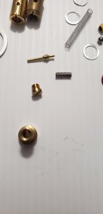

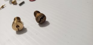

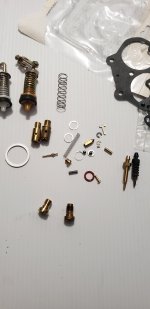

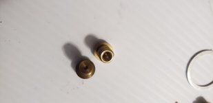

but u know i regapped to .045 and i think i have the wires in the right place but she wont start now? i took apart the carb to rebuild it dumb move when i opened it up she was brand new inside clean as a wistle amazing for a 18yr old carb. I think old owners took real.good care of it. my issue now is the rebuild kit power jet on bottom of bowl is different from whats in the rebuild kit? here are pics

If you are looking at the accelerator pump piston it will look different. They changed the rubber to an ethanol resistant type.

the main jet is the one with the push pin embedded inside right? well as u can see in the bottom pics, its way different its wide open on the bottom end. i just put back the original one , its a little torn up on the top but the pin still moves freely .

Don't know about the "push pin" but if the hole is a different size then use the old, it will work fine

The size of the orifice in the power valve and the height of the pin need to match the original so the piston/rod that actuates it will work correctly.
Mikes Carb parts can probably verify if you have the correct one. There are several that fit Rochester 2 jets and Mercarbs. Make sure the piston/rod operates freely.
Its not unusual for the jets to be hard to get out. As long as you go back in with same size it will be fine.

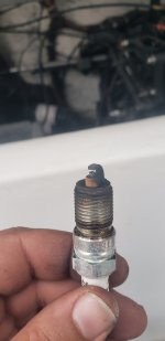

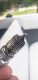

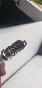

ok fiddled with the carb a little got her to start for couple seconds running very rough and she died.. wouldnt start again. I havent put back the spark plug gaps back to .030 ( how they were before i started to work on the engine and it was running decently ) now they are at .045 maybe thats the issue. i will find out sunday But how do the plugs look i took the pics when i regapped them last week. There is oil on the threads , valve cover ?
alldodge
Mar 8, 2009
44,673
Look good enough to run. Changing gap won't cause a non-run issue unless the coil is taking a dump. Very few coils actually go bad
