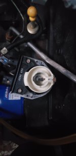

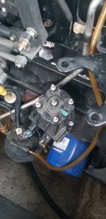

ok i tested all the cables and spark plugs with multi meter and all are good the inner contacts of the distributor cap were corroded a little i cleaned them out it back.I also turned the idle screw clockwise some more and she ran for like 10 seconds and turned off ?? 🤔🤔 i just rebuilt the carb again. For the float drop i measured about 20/32 and upside down around 1 and 5/32 close enough? i added a little bit because the gasket in the kit was superthin not like the original one. all thats left is maybe timing or distributer off ??
ilove2fixx
Feb 13, 2016
501
here are pics of the cap

And get a new cap and rotor. I'm wondering what the orange stuff is under the inside of the dizzy?
