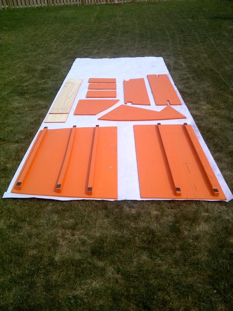

I have finished cutting all the wood. In the process I had to make cutouts for latches. Here is the template:
I have used straight router bit with bearing on the top to cut out all the latches:
Here are all the pieces ready to be carpeted:
During carpeting I have realized couple things - first that I really hate carpeting glue (2 days for pulling it out of my bodily hair ...... no fun at all). And second that the marine carpet was 100% right decision. I would have had a horrible time bending the thick garage flooring to the plywood And I had to make several adjustments to the wood in the process (to compensate the thickness of the carpet), so the idea of using spray on box liner did not work.

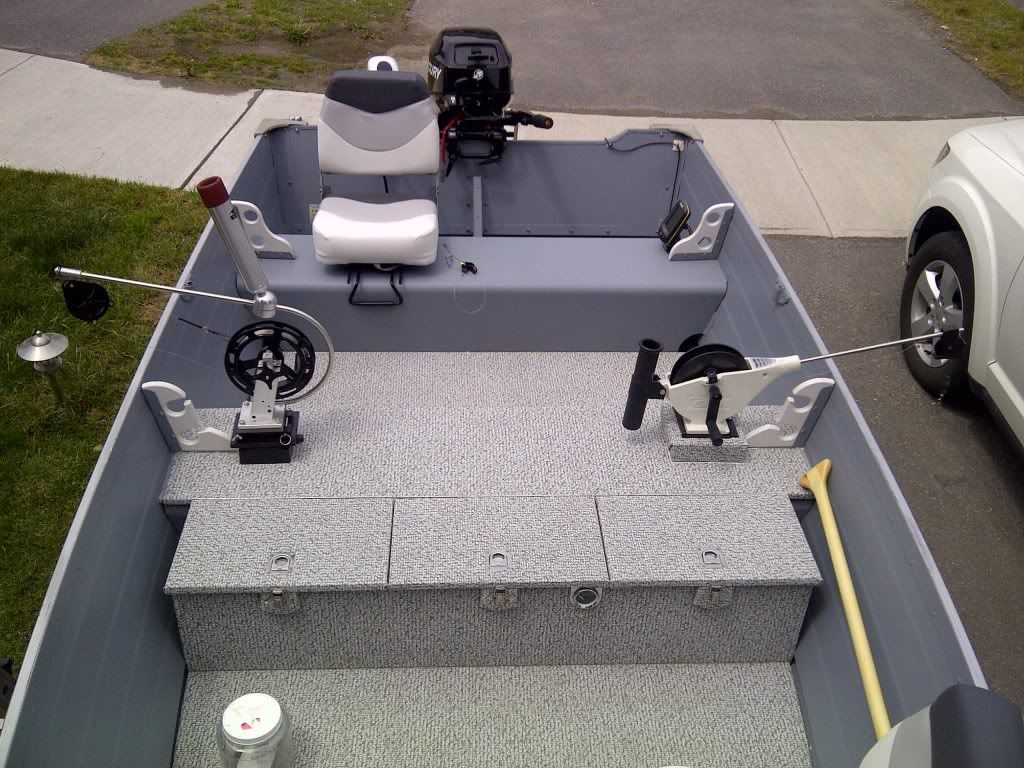

Ok, I can finally say that it is completed...... mostly ;)
Here are some pics cuase u guys like them.

Splashed it yesterday and it was great. I like the room inside. Feels like it has more room inside now, because everything is not sliding to the middle of the boat due to sloped floor.
Caught some nice pickerel in the middle of the hot-hot-hot day yesterday, so it was an icing on the cake!
