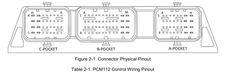

I found some information (tech manual) on the PCM112 controller, and noticed that there is a battery reference wire, which is Pin A4 on the C-Pocket connector. Other voltage sources are on Pins E4, F1 & 2.
The Battery reference wire has a 2 amp fuse in series. So, I will try to see if the voltage at the pin is lower than the battery voltage, meaning a voltage drop across the wiring or fuse. There are some 2 amp fuses on the engine, along with other fuses.
We shall see how that goes. In my Internet searching, I've come across some folks saying that replacing a fuse corrected a low voltage warning. . . maybe it is the 2 amp fuse.
A small amount of resistance (5-10 Ohms) potentially could drop the voltage by the 1-2 volts that I am seeing (If the PCM is measuring voltage correctly).

The voltage at pin A4 of the 'C' pocket connector is exactly the same as the battery. 12.87 volts
I removed and cleaned the 2 amp fuse. The resistance of the fuse was negligible - same as a short circuit.
I Powered the engine back up and ran it . . . still is getting the critical voltage warning.
I have a couple of Rinda Diacom screen shots - Stbd engine not running, and running. Also the VesselView settings and warning history
Something seems to be dragging down the voltage on both engines - the starboard being the worse, or the PCM's are not reading the battery voltage properly. Port engine reads about 1.0 volts low . . . Starboard engine reads about 1.3 volts low and sets off critical warning.

If you can access the main + stud on the fuse box, what’s the voltage there? Any drop between the bat switch & fuse box?
How’s the fuse box negative to battery connection?
I found a high resistance circuit in my old wiring harness by measuring both then running jumper wires to figure out which side (+ or -) the problem was on… Instead of pulling apart the old harness I ran a supplemental feed to the + side where the drop was and after that everything worked better….
tpenfield
Jul 18, 2011
19,581
You bring up a good point @Lou C The ground lead for the battery voltage ground pin at the PCM could have a bad connection . . . I'll see about checking that as well.
