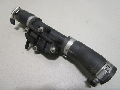

The P/S fluid cooler is P/N 8M0095482. I believe it looks like this . . .
I am wondering if it is a straight-thru cooler as Dubs mentioned, rather than the honey comb style.

Just for the newer model 8.2lL oil cooler reference 8M0045696 looks like this, https://www.ebay.com/itm/285301281387?_skw=8M0045696&itmmeta=01K0KBJZ0Q2721SZ7CJQPWM3GE&hash=item426d48126b:g:RxYAAOSwHxJkb5lU&itmprp=enc:AQAKAAAA0FkggFvd1GGDu0w3yXCmi1cWOMFH6+GgPcGQGM2MoxzMJjYJGz0jAdQ2FIf1rZw6eG0LvpxXOIME8hcmWrIdWx1auyfiXCc0Yf07r6/WCt5TfwMU1cQs4H9hFVybc+LMvXoEUnB5sqLaaWWoRPUtabGdGitaXl3vaqK7lhLBEECz0WhAxh0CpaaIYH9Iw9mAKwbqvJqXjzch8ViwrlAPo5M4MyDv8b+OdjGa/dADHkUSNAMTvIvt1QpAN/m4Jb2/nwn8eg+3ri1vqIoVyTlia/E=|tkp:Bk9SR77wy-uEZg
