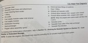

If you haven't seen it yet, i found your service manual and it shows the water flow and suggests the strainer (F) I mentioned earlier is for the fuel module... The link will start at the beginning that covers both standard and closed cooling but you got to scroll through them to see the differences and the notes on the next page that may and may not cover the previous water flow guide shown of each design differences.
a -
Seawater inlet
b -
Seawater pump
c -
Power steering fluid cooler
d -
Y‑fitting
e -
Drain fitting
f -
Fuel supply module water inlet strainer
g -
Fuel supply module
h -
Distribution housing
i -
Drain fitting
j -
Y‑fitting
k -
Water circulating pump
l -
To engine block (from water circulating pump)
NOTE: When the poppet valve opens water will flow into (r and s)
90-8M0099748 eng DECEMBER 2015
m -
To crossover (from engine block)
n -
Crossover with 60° C (140° F) thermostat
o -
Exhaust manifold seawater inlet and drain
p -
Exhaust and seawater outlet
q -
Poppet valve assembly (green)
r -
Exhaust elbow seawater inlet (poppet valve closed)
s -
Exhaust manifold seawater inlet (poppet valve open)
t -
Starboard exhaust manifold drain hose
u -
Port exhaust manifold drain hose
v -
Starboard engine block drain hose
w -
Port engine block drain hose
x -
Oil cooler

This diagram from the parts list shows slightly different routing to the poppet valve (I believe).
Fun Times
May 16, 2009
9,408
More so need to go by the manual vs a parts guide as parts catalog is usually found off in its routings and then since your manual was made in 2017 vs the linked 2015, it would be worth seeing if they are the same or not and if different then the later one (17) is the up to date one mostly because mistakes were found as time went on either by MerCruiser employees or dealer service techs in the field and reported as so for correction...<That happens a lot more than one would hope.
tpenfield
Jul 18, 2011
19,389
Well, I’m also thinking the manual is the more correct version, as the only way for raw water to exit the system is via the risers. The manual more clearly shows that.
