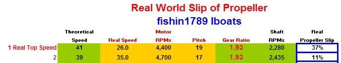

Fishin, if this is a guess and not GPS speed everything I say after this means nothing.
With the numbers you gave me I am showing you have a prop slip of 37% and that is unbelievably high. And if you couple this with your RPM only reaching 4,400 RPM it looks like you have some real problems.
Prop Slip
I have a recommendation for a much better prop than you are running right now, but I believe that there are other problems we need to address before we change props. If we change props at this stage I believe we are just hiding a problem that is somewhere else and needs to be taken care of.

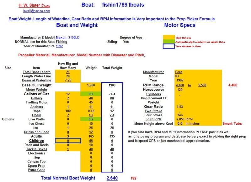

It currently has a 3-blade aluminum 13X19 prop.
12. Make, model, diameter, pitch and whether SS or aluminum prop Unknown mfgr. 13X16 3-blade aluminum (almost new)
I assume you just made an error in the pitch of the prop and it is actually a 19" pitch and NOT a 16" pitch. Because if you changed to a 16" prop and are getting the same RPM we need to fix the motor for sure.
The information I have shows your boat to weigh 1,900 pounds and the allup weight during your testing to be about 2,600 pounds.
Boat and Motor
I believe there is a good chance that your tachometer is not showing the right RPM. You need to turn the switch on the back of it 6 or 8 times to try and clean the contacts and see if that changes your RPM at WOT. Please take the boat out again and bring a GPS and a hand held tachometer and verify the WOT RPM and speed. When we have this I will make a prop recommendation and feel that we have done everything we can to find a better prop and we have maximized the speed for your boat.
