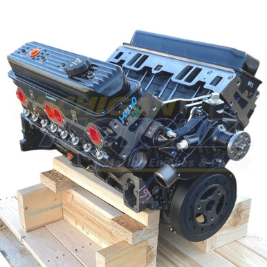

before Merc started making their own 4.5 and 6.2 engines they were buying base engines from GM. THis is an example of what a base engine is and contains-
both Merc and VP start with the base engine and add their unique parts to it. When I repowered my boat in 2015-16 I bought a new base engine from Mich Motorz, and was thus using the exact same engine the OEMs use.
