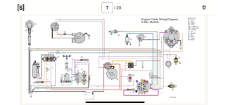

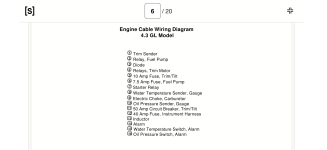

I just posted a reply to @alldodge about the ran/black wire. I think it goes to the oil pressure switch but I can’t find said switch.

Either Teed with oil pressure sensor or look below the Dizzy and it might be there on the rear deck. If there is just a plug filling hole then switch was left out

Oil pressure switch is right above the oil filter - or if you have a remote oil filter, above where the adaptor attaches to the block.

Yes but the oil pressure gauge sensor is normally there. Does the oil pressure gauge work?
If it does than sensor is elsewhere

Yes it works but it’s a little jumpy. I was thinking of starting a new thread to figure that out. This is the sensor next to the distributor, right?

Looks like either this never had the oil pressure switch or someone removed it and let the switch connector dangle. Usually there is a sender which feeds the gauge as you identified up by the distributor and a switch that turns on the warning horn down by the oil filter.
