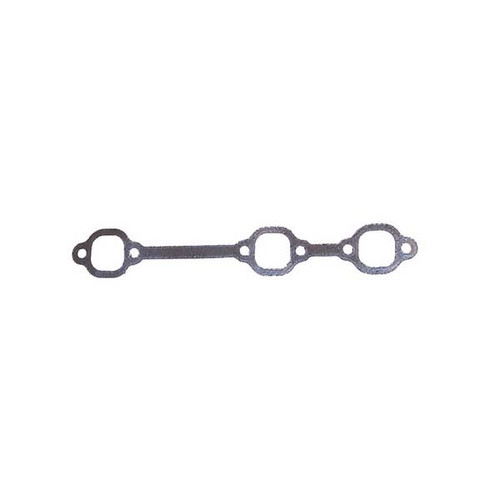

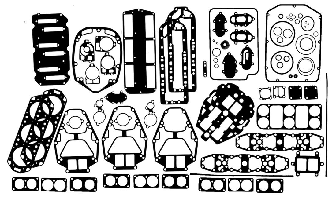

Alright, so I hope I have this right. I am keeping the heads, intake and carb from my old motor due to unavailability of low priced vortec intake and 4bbl carb. I'll hang on to the heads and keep my eyes on the used marketplace in my area. I plan to use the bolts that are different from the donor motor for the starter and plan to, for now, keep the original starter from my current motor (this is kind of a bandaid to get us by until we find the right upgrade for us). The following is a list of things I am purchasing. I understand I may or may not need a new water pump. Any way to tell before I get a new motor? The picture I posted was what I could see of a casting number. "gm 4.3L" is all I could make out. I'll try to get eyes on it again and see what I can find, but there isn't a lot of room to see much else at the moment. There appears there are numbers under it, but they are not legible to me. Any other tools I need to pull a motor from a truck or for this job overall? I assume I will need to set the timing with a timing light? Anything I'm missing/overlooking?
1 of these:
8 of these:
2 of these:
1 of these:
an engine alignment tool
