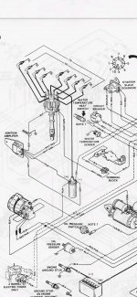

I can't tell how you actually have things connected. Here's the wiring diagram (maybe. We don't know what you're working on)
