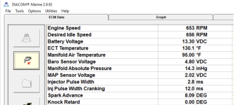

Grr. That is frustrating, my friend! Nothing much fun about fixing a poorly running open-loop EFI system.
Have you swapped the coolant temperature sensor? I know things can go sideways real quick if the ECM doesn't know the correct engine temperature. And that temp isn't shown in your graphs.
vroom ZOOM
Aug 15, 2017
474
ECT sensor seems to be reading just fine.

Well, I just honed in on another huge clue. I ran a data log through diacom on the working engine to get some numbers. At idle, the IAC is around 17 counts and the injector pulse width is 3.4 ms. On the broken port engine, the injector pulse width is 2.5 ms, even going down to 1.8! So for some reason, the starboard engine is getting almost DOUBLE the fuel! Which explains why this engine feels so lean! No wonder it doesnt want to run! The question is, what would force the ECM to pull so much fuel out? Why is the ECM leaning the mixture so much?

Here is a Diacom reading from my 7.4L LX engine at idle, similar ECT. . .
Notice the difference in injector pulse and the MAP
On my running engine the pulsewidth is 3.5, and map is around 21. BUT the port engine did decide to idle today at one point, albeit very rough and borderline stalling. I did record the data though. Injector pulsewidth and MAP was at 3.5 and 21, just like on the starboard engine but it was running like CRAP!
This leaves the ONLY difference in diacom readings between the two to be.... THE TROLL MODE INPUT mystery! I am probing all the pins on the ECM to figure out how the heck it knows which engine it is attached to...

Here are the engine speed, injector pulse, and MAP as a graph.
Overall the injector pulse looks low. MAP also looks fairly low.
Maybe send me a similar file from your 'good' engine for comparison.
