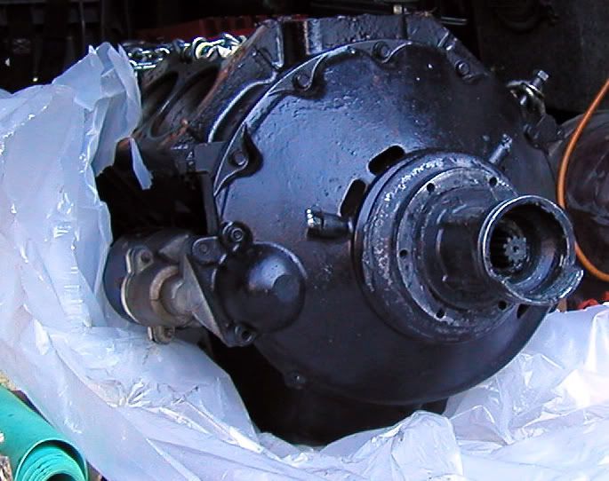

f_inscreenname
Aug 23, 2001
2,591
Re: 454 questions
I thought the starter bolted to the bellhousing????? Not the block. Thats the way it is on my Mopar.
