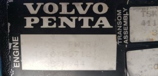

Pics for everything I could find about the engine model are posted.

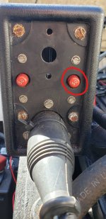

I have some related questions about what appears to be a 50amp fuse labeled 'ignition protection' where the 10 pin connector (pics uploaded). There is a red wire running from the positive terminal of the coil to the 10 pin connector and I'm wondering if this is something I should be looking at?

For the GL PWTR the wiring comes from the Battery, thru the 10 pin connector, to the key switch and back to the coil going back thru the 10 pin.
Starter post Red wire to breaker
Breaker red/purple to 10 pin
10 pin to key switch thru 15 or 20 amp fuse
Key switch (RUN terminal) Purple thru kill switch to gauges and 10 pin
10 pin Purple to Coil and alternator
52,316
check the MOB switch. the MOB switch is after the key switch, however before the 10-pin connector

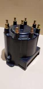

I do intend to replace the rotor and cap. I ordered a new cap and plug wires only to discover that my distributor in not OEM so I couldn't use them. The don't think the coil isn't OEM either.

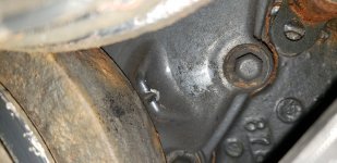

Well alldodge made it sound so simple I jumped in without really knowing everything I need to know. There are still too many missing pieces for a novice like me.
So I warmed up the engine and connected the light to see what I could see without really knowing how to set it up or what to look for. And I didn't see anything or maybe I did but just didn't know it.
I wasn't sure what to do with the advance dial on my light so I set it to zero.
I watched some videos but every one seemed to have at least one variable that didn't apply to me.
In one of them the guy removed and plugged a vacuum hose from the distributor. I don't have one of those. Another video used advance markings on one of the pullies that were already there. I don't have any that I can find.
The only marking I could find was on a plate behind the harmonic balancer (pic uploaded). But I'm not sure what to do with that. Is that where I draw a corresponding mark on the balancer?

alldodge
Mar 8, 2009
43,913
Kenny is the guy that knows VP
For having just a notch you need to look at the balancer for a larger mark followed by some smaller ones.
Having an advance timing light, need to set the light for 8 BTDC (assuming that is correct timing for the motor). With motor running the point in your pic will align with the notch on the balancer

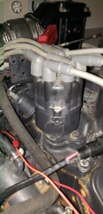

Try to post a picture of the distributor
Sorry the picture ain't the best... it's dark outside now. I also included the OEM distributor cap I bought.

BTW I did my best tonight to find any advance markings but came up empty. I even put my phone down there with the light on and took a video. If there are markings I can't see them. The balancer has a decent amount of surface rust so that could be covering it up.
I have some of that stuff that turns rust back into metal so maybe I'll rub some of that on it tomorrow to see if it reveals the markings I need.

alldodge
Mar 8, 2009
43,913
Take a piece of sand paper to it. Then bump the starter as brief as possible to see if something comes up
