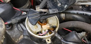

The picture #355 is a Prestolite, does it have points and condenser or is it electronic? Volvo used Prestolite on all their “V” style engines. They phased in the electronic version in the 80s and used the same body. If there is only 1 wire going into the distributor then it is a breaker point version. 2 wires then it is electronic.
If yours is the breaker point style then it needs a resistor that provides 8-9 volts when the engine is running.
I really appreciate you identifying the distributor I have. It's very helpful.
Based on what you said it looks like I have an electronic because there are two wires that connect to the coil and I don't see any points.

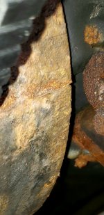

you wont see any numbers on the balancer, your looking for a line/groove cut in the balancer. That is TDC for #1 piston. Also TDC for #1 on the exaust stroke

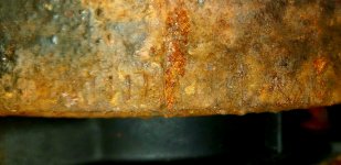

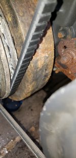

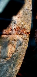

Found them. With all this surface rust it's going to be challenging to pinpoint 8 BTDC. These pictures were taken after I did an initial wire brush and wipe down to make them a little easier to see. I clearly have more work to do.
I also need to get a shop tach or something because I don't think the helm gauge is accurate enough to set the timing.

Use a white grease pencil or bad of white paint on the notch. Adjust timing light for 8BTDC and let it line up with the pointer.
With that kind of rust you must be in salt water

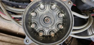

Thanks for looking up the serial number for me. I've been wanting to replace the cap (ordered the wrong one). I have tried to clean the contacts twice but I think I need a new one.

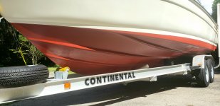

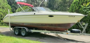

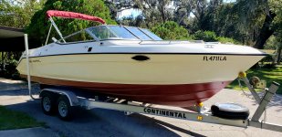

It spent the last decade, maybe more, in Tampa bay. It had bottom paint when I got it so it was wet docked at some point.
If I were keeping it I'd remove the bottom paint. But I'm selling it so I just repainted it. Here's a before and after.

The cap doesn't look bad to me, but looks can be deceiving. Cap and rotor would be a good thing

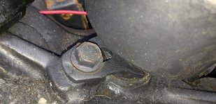

I found some corrosion the first time I popped the cap. I did my best to clean it up.
BTW: Looks to me like my distributor is all the way to one side of the adjustment bolt... retarded maybe?
alldodge
Mar 8, 2009
43,916
That's a clamp which holds the dizzy but is not put of. Should be able to move once loosened.

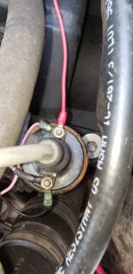

Help... I'm choking!
I twisted the electronic choke back from it's nearly centered position until the butterfly just barely closed. I also noticed the butterfly was sticking to the side of the throttle body a little so I lubed and worked until it moved freely.
Following this video:
I tested the connections to the choke and was surprised to find little to no voltage (just like what was happening to my coil). So I connected it to a 12v source and the butterfly opened all the way almost in about 30 seconds. Once open it was pegged for several minutes.
kenny; You asked it it got warm to the touch. I would say it's more hot then warm. Not so hot I have to remove my hand but close And it was connected for less than a minute. Does that sound normal?
Holley's video seems to indicate that the cam should be moving with the throttle and that's not happening with mine. Moreover, the video showed how to use a set screw to adjust the high idle that should be seen under the choke housing when at WOT but I don't have that either.
I'm more confused than ever about the choke. I know when I adjusted it before it did have an affect on cold starting so I believe it is or was working. But how is that possible if it doesn't have 12v? And why did the choke open so quickly when connected to 12v? My limited understanding is that it should be closed to start and then open after the engine is started and and warms up. Is that correct?
If I turn the key that choke will open in about 30 seconds, get hot and stay open the choke (not the engine) cools down. So if for some reason it didn't start within the first 30 seconds of turning the key it would be pegged open and nearly impossible to start.

Its opening quick, maybe to quick, but not going full open. It should be straight up and down.
The marine carb does not have a high idle cam like an auto. The auto has a cam the will open the throttle a slight bit more. The boat idle is increased with the throttle handle in throttle only mode
It looks like your carb is working correctly for the most part

Your alternator may have a stud marked “stator”. It is only hot when the engine is running, it should have 12 volts. If you have that setup connect the choke to that terminal.
You do not want to use the circuit that powers the coil.
Another way is with a electric fuel pump safety switch that is normally open until there is oil pressure. With that set up you can have the switch wired to a continuous 12 volt source, this is also a good way it wire in a hour meter.
