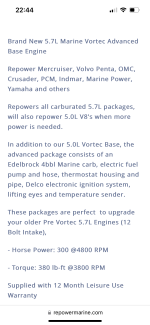

Edit…it’s as pictured below. But with petronix ignition now and Holley carbs as described above. Says 4800 rpm there at 300hp. Not sure about getting that with 4800 rpm, but not an expert. Thought his were 5000 rpm at 300hp anyway.
