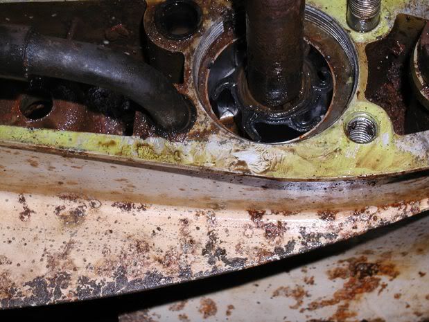

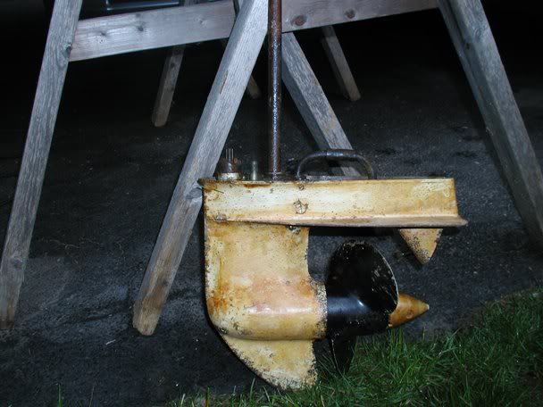

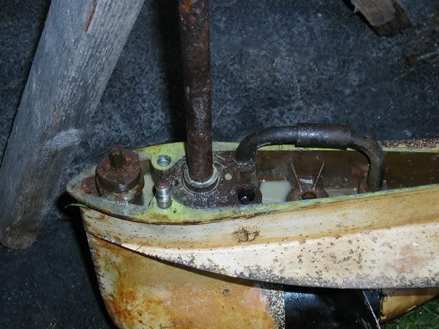

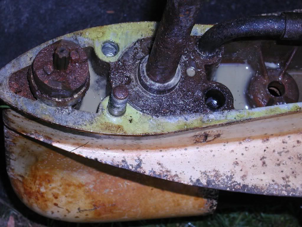

Update....I got the lower unit off without much problem. And what a rusty mess I have found. I am going to take a couple of pics and upload here again shortly. Green/milky water in the lower unit cavity along with big chunks of rust and the lower part of the drive shaft is pretty rusty as is the housing around the shift rod.
Here are the pics.....how do I get the impellar out? Two screw drivers wedging/leveraging on each side to pry it up?
The impellar actually looks in pretty good shape but since I have the replacement and have it all apart I will replace...assuming I can get the old one out?

Ok ...after everything going so well I am stopping as I realized I could be damaging the threads for the water pump cap or whatever it is called, by using screwdrivers trying to pry it up. I now have to replace the impellar as I have mangled it pretty good trying to get it out.
It's soaking again with PB Blaster.....what to try next? I am not sure if I can get a dremel into there to cut it?

I am such a bonehead. I finally managed to wrangle the impellar off and then in my haste to get it back together....took the lower unit over to the hose reel to wash out the accumulated rust and dirt in the cavities etc but forgot grab the impellar keyway/pin or whatever and blasted it out along with the grime somewhere. I have been searching through the grass and ground cover etc but to no avail. Now what? Where can I possibly find another?
