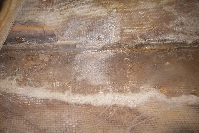

Had a friend come over and since i still had access to get under the boat , i used posterboards taped together and follwed the line from the underside that the stringer sits in . ( just in case the stringer breaks apart , i can fall back to this and also opps post on scribe method )
My trailer has bunks but not real long so we made some temps one just to be safe . I checked the stringer height at 1 foot intervals , but also noticed the stringer in most places is not even to where the deck would sit . The back of stringer is about 1/2 inch low and up to the front is about 7/16 th inch to high. Is this something to worry about now or just make the stringer slightly taller and trim it down later ?

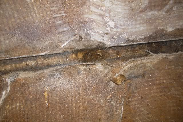

We removed a section of the stringer to see what i would be dealing with . Sure enough the stringer was sitting of foam . I don't think this part will be to bad to clean up , but man look at the sanding i got ahead of me to be able to glass the new stringer in . I will need to fill this area full of Pl so its even with the hull correct ? Few pics below .

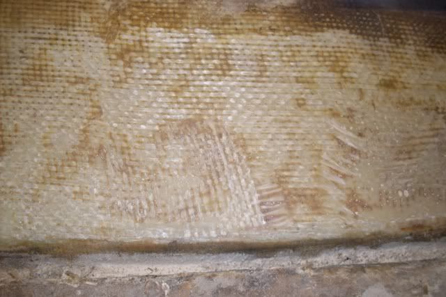

Quick question , i used the 36 grit on the grinder to cut around the old stringer . I don't want to grind to much off ,or get into the woven part to much , will this be good for when the new glass is laid on the stringer ? I will go out from the stringer alittle more , thats about 8 inches out in the pics below

Yep, looking good so far. 8" should be good enuf. Don't worry about the mat so much just make sure you get down to good clean glass so the new stuff will adhere properly.

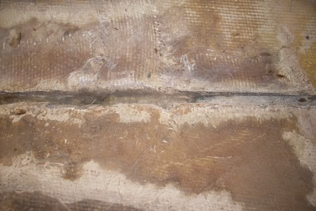

Better the stringers are too high up front, that way the deck can drain and be self bailing.
You can set the stringer to deck height by placing little clay balls on top of the stringers and laying the deck down, examine the clay balls to see if they are contacting the deck. Chrysler placed wads of chopped mat on top of the stringers then drizzled resin into it and plonked the deck down.
You can see that in your own pics.

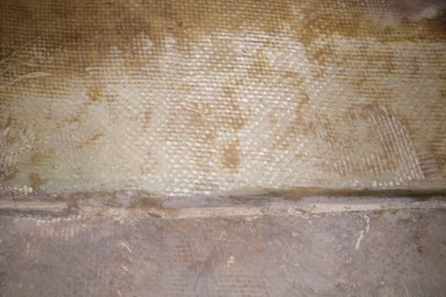

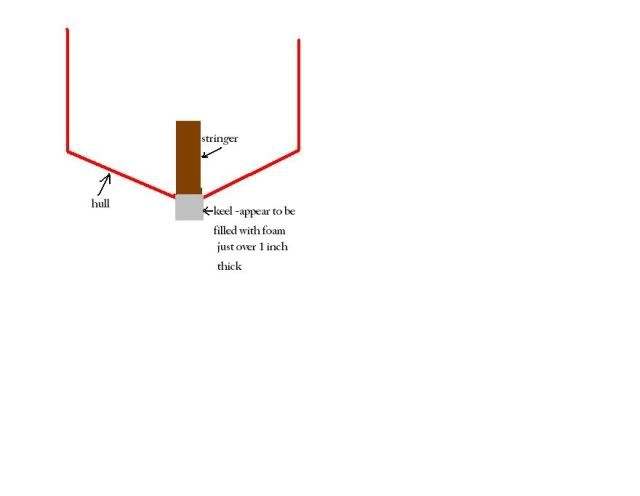

Almost done grinding and cleaning :) I just need to know what to do with the stringer now , since mine only uses a keel stringer and by looking at how it was ( if its original ) the stringer was sitting level with hull and appers it was solid foam in the keel under the stringer . The keel starts almost flat but quickly goes to just over 1 inch deep for most of the stringer run.I want to use Pl to bed the stringer, but is this to thick ?( 1 inch ) . Or would i be better using foam to fill it , and if so on the foam , is it 2 part foam to fill it and still use pl to fillet so i can get the glass to lay better ?
My ms paint skills are horrible , but heres what iam meaning .

On my thundercraft I filled the keel because the thickness of fiberglass under the main stringer was very thin. The OEM built the hull in a mold. The slot that forms the keel was very narrow. Instead of doing it correctly it looks as thought they used light weight fiberglass to form the keel. It was very thin and brittle. To fix it, I used strips of roving and mat and completely filled the keel over a couple of days. 1 inch of PL is really too thick. I would either fill the area under the keel stringer or, cut the stringer to fit the slot, then lay the stringer in place. The most glue you will need under the stringer is about a 1/8 inch. This is plenty to bed it, you just need to pay close attention to fitting it to proper height and profile where it meets the hull. The idea is to keep the wood out of contact with the fiberglass of hull, avoiding hard spots.
If you decide to fill the low area in the keel keep in mind that you should add layers of fiberglass in incriments. Dont do it all at one time. Laying all of it wet that thick will cause excessive heat as the glass cures. It may crack. You may also want to consider some other form of filler, like shims and tickened resin with fibers or even fll it with wood shims. 1 inch of fiberglass is very thick.
To bed the stringer use some cross bars cut from 1x1 or some strips of scrap you have laying around. Cut them and screw them crossways across the top of the stringer so that they rest in the deadrise of the hull and support the stringer in position off the hull. You need about 1/8" of open space under the stringer when you put it in place. When you get that good, remove the stringer and get it out of the way. Then run a bead of PL down the length of the keel. Place the stringer back in place and let the PL sqeeze out along the stringer evenly. Have a scraper and some paper towels handy so you can scrape off the excess glue that squeezes out of the gap. (dont try to use the glue to fillet the inside corners, scrape that off) Let the glue cure a couple of days and remove the supports. WALLLA! The glue will hold the stringer in place while you glass it.
