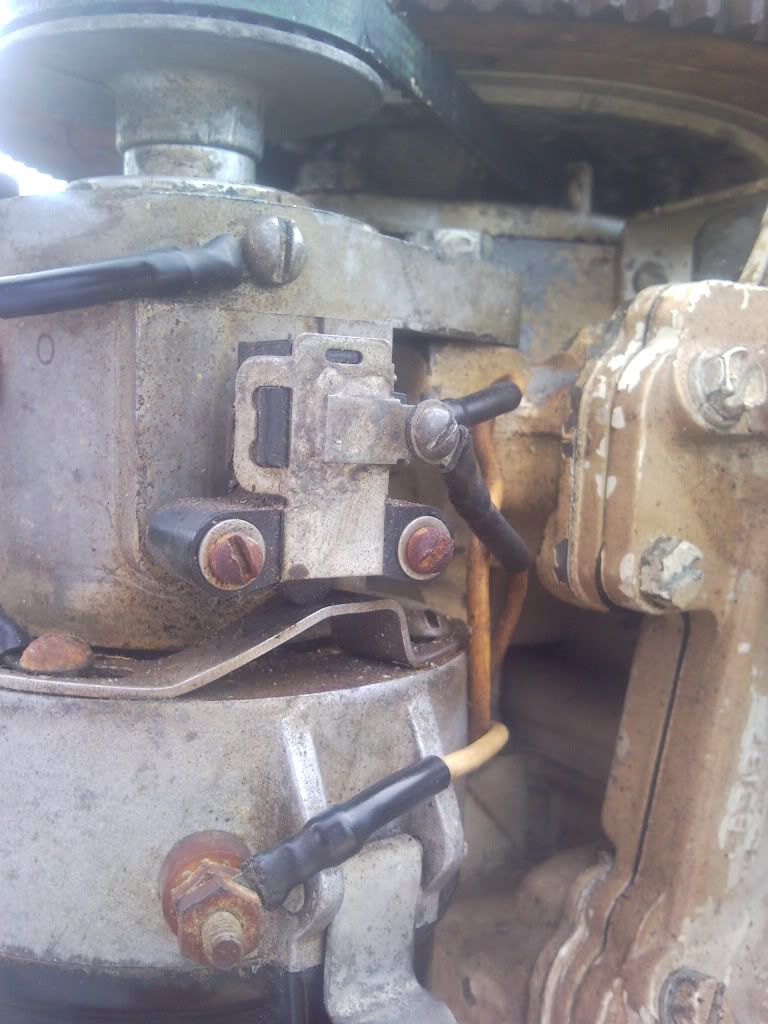

I have some pictures and questions as I get started. I have worked on a couple of johnson motors and 1 120HP Chrysler (Circa 1970-ish) motor as well as a lot of cars. I am no expert but I consdier myself reasonably mechanically inclined and electronics are something I find interesting and fun.
That being said, here are some pictures and questions as I've never seen an ignition system like this!

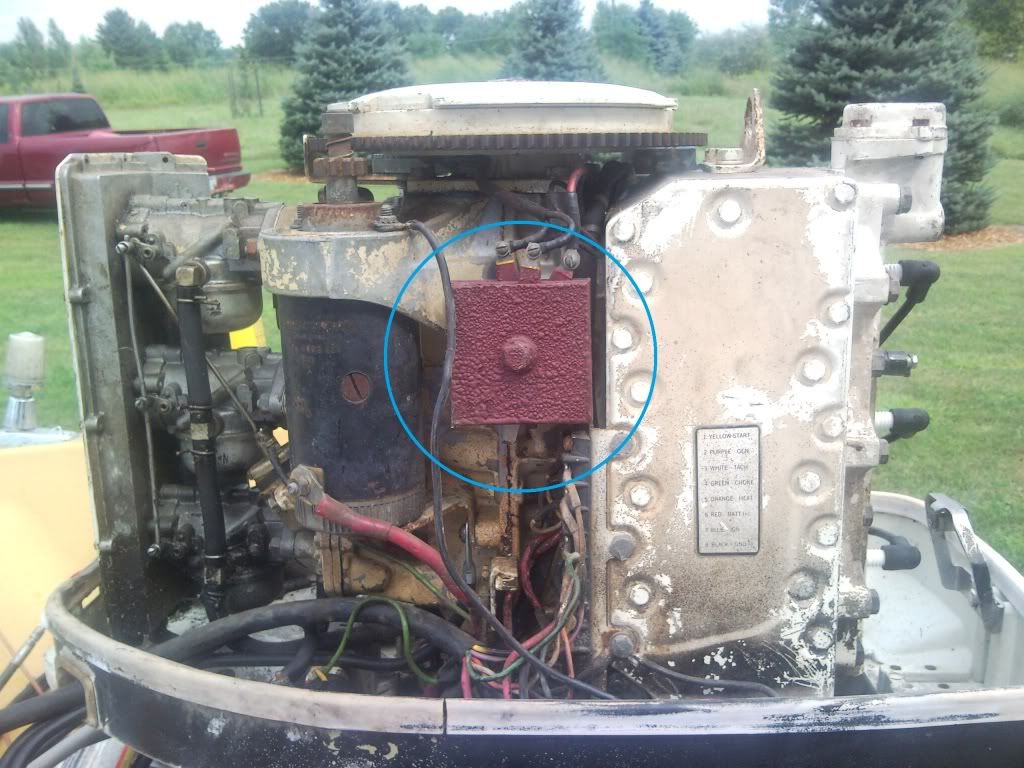

(#1 Pic Above) This is a side view of my motor. The "Resistor" that I mentioned is what I have circled in blue. The two wires from the stator run to this as well as a + (Red) wire. My understanding is that this regulates the charging and sends current to the coil. I'm looking to verify that this is correct.
(#2 Pic Above) This is the opposite side of the motor. I have boxed in the coil in blue. Also, there is a small component on the side of my distributor that I have boxed in green. I think that the component in the green box is the "Pre-Amp" but I'd like to verify that. Also, I don't understand what the pre-amp does? If you could tell me what this thing is, and what it does, it would be great!
(#3 Pic Above) This is a close up view of the component that was boxed in green from the previous picture. I took a close up so that you could get a good look at it.

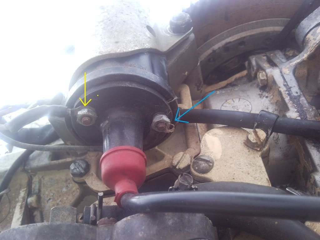

(#4 Pic Above) This is a bottom view of the coil. The blue (Igintion) wire runs to the right side and the wires from the resistor in pic #1 run to the other side. It was a "High tension lead" (I think that's what it's called) that runs from the coil to the center of the distributor cap. My understanding is that the resistor sends current to the coil and then distributor tells the coil when to fire. When it fires, it sends current into the distributor cap and onto the spark plugs. Is ths accurate?

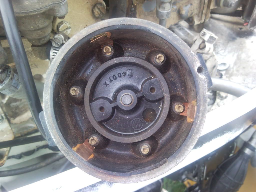

(#5 Pic Above) This is the inside of the distribuor cap. In my opnion, it's a bit of a mess. Is this something that I can clean up myself? (Dry cloth, lightly sand the posts, etc) or is is something that is better off replaced? I read somewhere that once corrosion starts in a cap, it pretty much will continue to corrode and should be replaced. I'd like some input on what you (Or anyone else) thinks I should do. Thanks!
I should note that the center (Carbon?) knob that is mounted to a spring is slightly broken off. If I decide to keep this cap, I will replace this part from a cheap distributor cap. I attached a meter to this knob as well as the other end of the high tension lead to ensure that it was still conducting... it is.

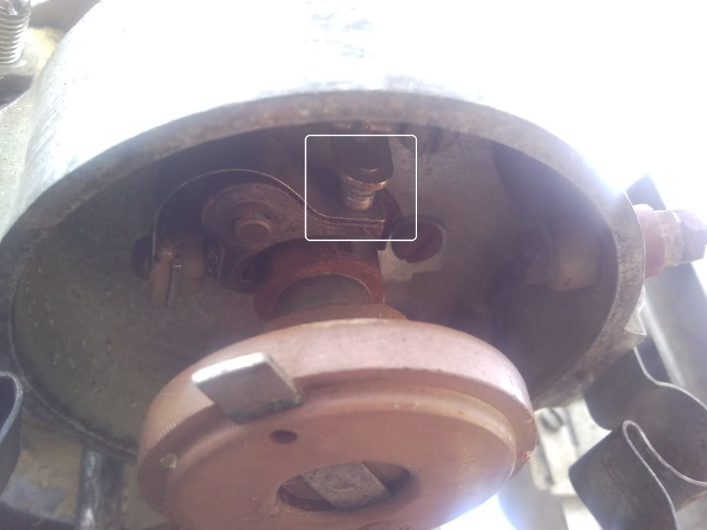

(#6 Pic Above) In the white box are what I understand to be the points. As the shaft in the distributor turns, it raises and lowers a point that "rubs" on the lobe. This causes the points to open and close. The gap between the points when they are open is the "gap" that is referred to when "setting the gap." It's currently set at 0.014".

Coil - Both terminals of the coil read as a positive charge. I used a testing light and when connected to either of those two terminals and then to ground... both sides read as + (Positive). Is this correct? I thought one of them should be a ground?

Points - I verified that the points connect when closed and are at 0.014" when open.

That's a stock Chrysler ignition. The item circled in blue is a selenium rectifier. In between the red coated steel plates are selenium discs. Selenium has the property of passing voltage in one direction at the interface.
The coil is mounted on the bent aluminum mount with a cast piece behind it. this is stock. Correct wiring is blue from "I" terminal to pos of coil and wire from neg coil terminal to points. When the ignition key is on, voltage is always flowing to the coil. When the points close, current flows through the coil primary winding and builds up a magnetic field. The amount of time the points are closed is called dwell and directly affects the strength of the field. When the points open, current stops flowing and the field rapidly collapses inducing a high voltage in the secondary windings. The coil is really a simple transformer that works on DC.
I don't see a capacitor inside the distributor and I have never seen the piece outside it, but I would be willing to bet that it is a capacitor designed to minimise arcing at the points.
Points are correctly set at .014, but timing needs to be set at full throttle 32 advanced because top dead center is not necessarily where the engine will run at idle.
The distributor cap looks OK except for the center button and if you can find a piece of graphite the correct size, you need not replace the cap. The copper strips inside the cap are grounds for the unused terminals.
Judging by a number of things I would say your engine is pre-1970 of very early: Lifting eye on the block, selenium rectifier, points distributor and regular coil. mounting of terminal strip, flat plate oil recirculation cover, fuel pump, carb airbox.
Oh! I didn't see correctly before. The thing mounted on the distributor in the green box is a neutral interlock switch. Actually it does not keep the engine from starting in gear, but rater, keeps you from starting it when the control handle has advanced the throttle. Coast guard later considered this arrangement less than safe and the switch was moved on later engines to the shift lever below the carbs--That prevented engine starting in anything but neutral position.
