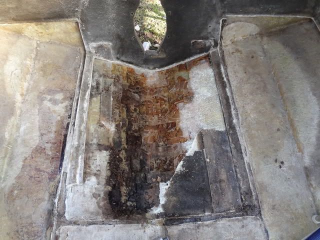

It was like 1:30 PM before I got to get in the boat. Didn't think I would have enough time to get much done before dark. As you may recall, I had to get the bilge area de-balsafied and rip the transom wood out.

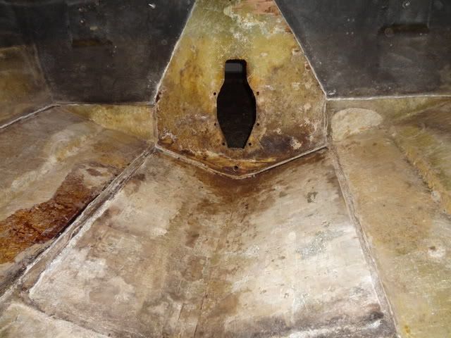

3/4 of the bilge area was a cake walk. The remaining 1/4 was a bear....
Down in the bottom, there was alot of this....looks to me like the resin was over cooked? There is alot of this on the starboard side from the foam redue that was done also...very hard and brittle.

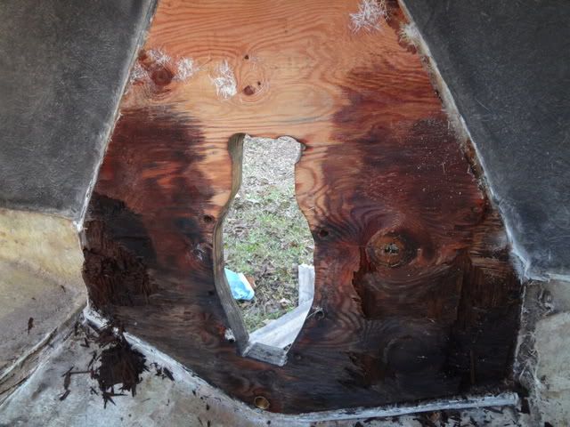

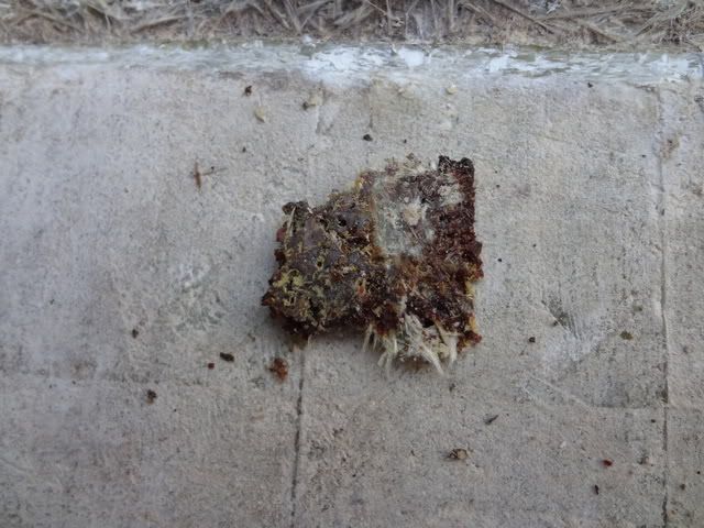

Got the skin off the transom...as you can see the wood was very wet, to the point that water drained out of the bottom when I was making my cut with the OT. I never did found it, but I swear I saw a redworm in the transon when I knocked the rotten wood out.

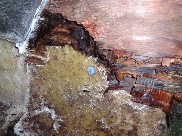

There was a layer of CSM on the wood where it lays against the hull. Flapped like a piece of skin when I got the wet wood out. I would say it was that way when this screw hole was sealed with slicon, see how it spread out. These were the holes made for the fish finder, so doubt they were from the factory. I suppose the delamination happened after the transom got wet.
I really didn't think I was going to get this far today. Worked 5 hours in total, no breaks. But I got the transom wood out! Upper half was a real pain to get out. I hammered my chisel between the hull and that layer of CSM I thought was disconnected all the way up. Wrong - It was connected fine up higher. Let the chisel spread it, sounded like rice crispies when the fibers started snapping. Let it got for a while and kept moving the chisel around, but it finally came out in the one piece that was left.

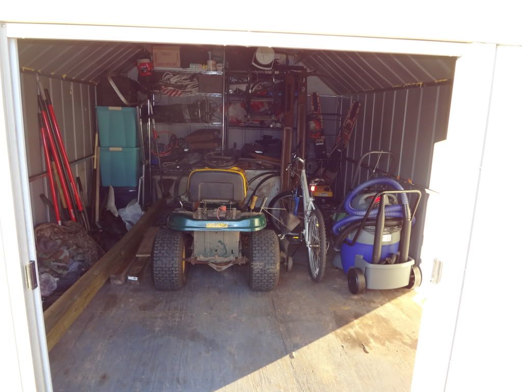

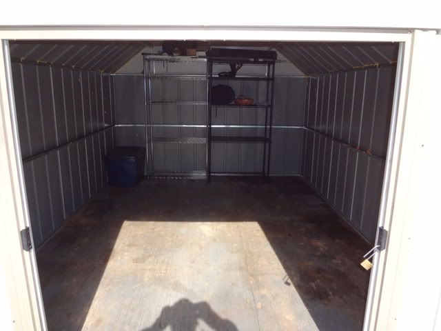

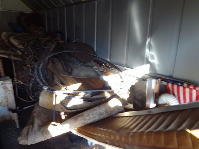

I decided to clean out the shed. Not sure who's thread I was looking at yesterday morning, but they had done the same thing recently and got me to thinking I needed to do the same.
Not actually working on the boat, but it does help with getting to the end of the project....
I think you will all agree.....
It really needs some work...
Clean slate!
Reminds me of the boat in a way.
Much better

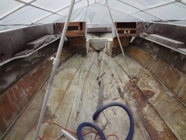

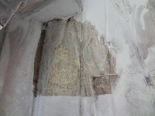

This was the first area I tackled. See the roving going over the chines? I suppose I need to take that all the way out?
I have a few tricks up my sleeve. For the fogging lenses I have been sucking the moisture out with the big shop vac.
If I had some long tubing I think I would just do this...
Progress for today...
Here is where I have ground so far...
