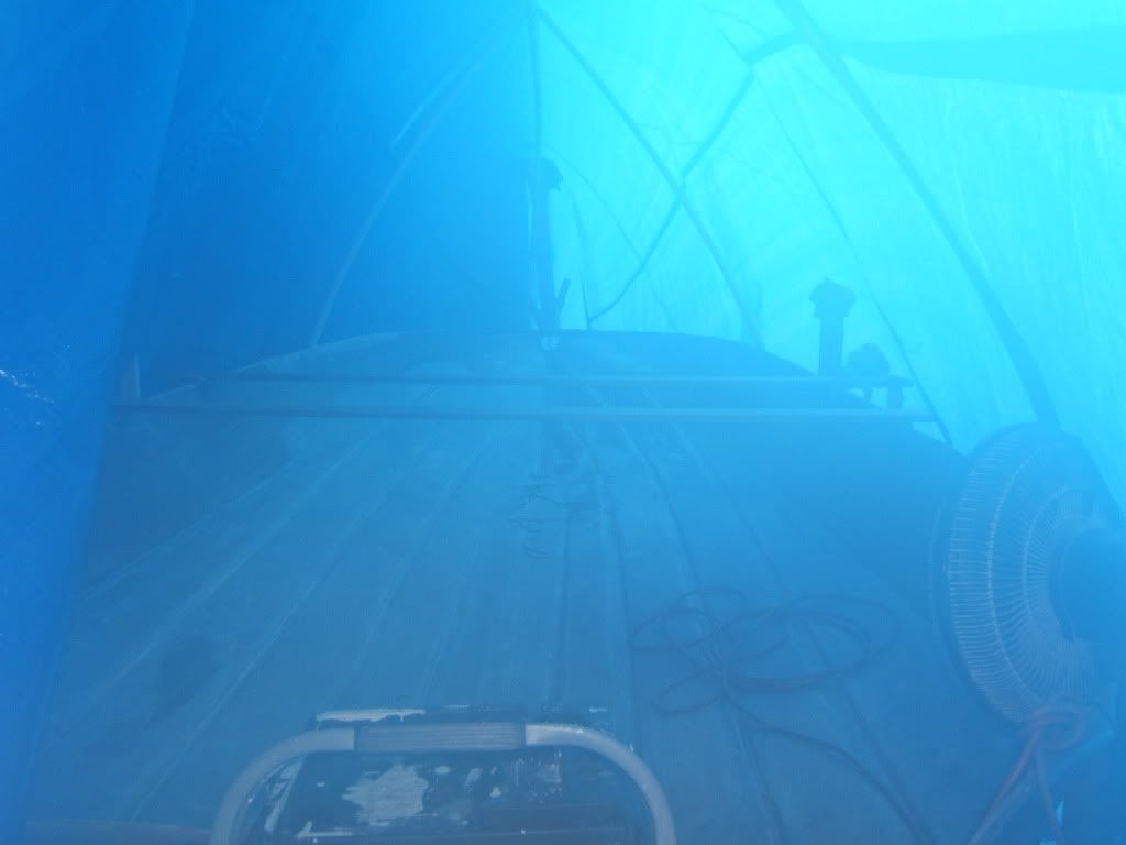

It is fun eh? Hasn't been too warm today, kind of overcast so the green house is staying cool.

I did most of my work under a tarp carport. I know what you mean about the greenhouse. I ended up putting a fan in the boat for some air flow. I don't know how you do it with all the gear on and under the tarps. Someone checks on you now and then I hope.

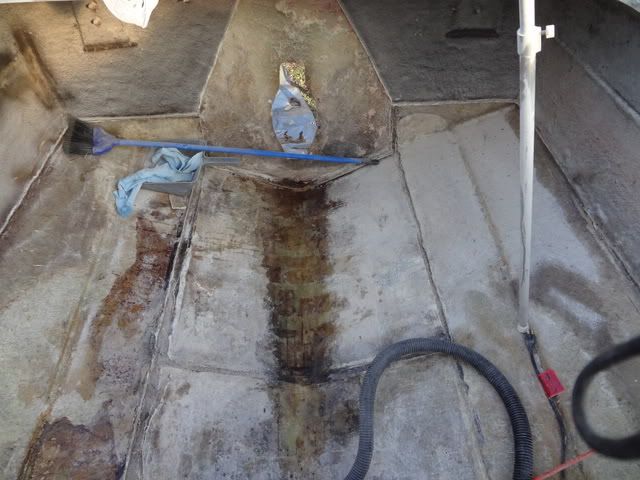

As you may have noticed, no update last night. We had some heavy rains yesterday, didn't want to track mud into the boat. Oh how I envy those of you with an actual workpsace.
Tonight I go out and there is water in the boat.
I had just vac'd it up in this shot. Do I need to worry about water so much during this stage? I mean it is resin/glass shouldn't soak up anything before it has a chance to dry, right?

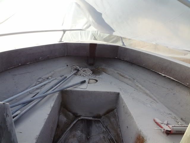

I looked all over the boat, for evidence of the water's entry. It really just looked like it entered from the transom hole. Though I did see this little leak. ZGoing straight into the foam on the bow. In fact during this evening's grinding session some water began to run out of the glass right underneath this area. It sure seems to me that there is an awful lot of glass layers in the floor of this boat. Earlier in the thread when I was pointing out areas I thought might be a repair, I am beginning to understand it was just the heavy weave of glass they laid down. Full of airspace too.

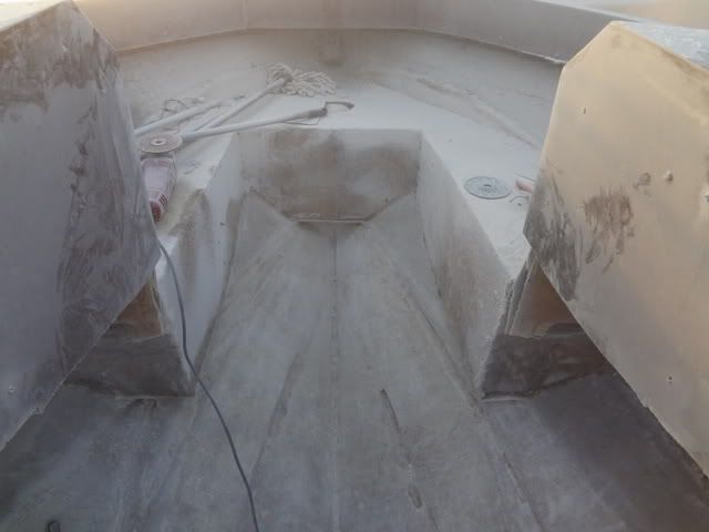

You can see in this after shot where the chine on the right is covered with this glass I mentioned. I have been cutting it away in most places. If it lays flat I leave it. Didn't have alot of time tonight, but I got the bow section ground in with where I left off on Monday.
Sure is alot of dust! I tried keeping the hose near tyhe grinder - saw little help doing this. Almost forgot - tried putting soap on the goggles, I only had to clean them once, but it was rather cool today.

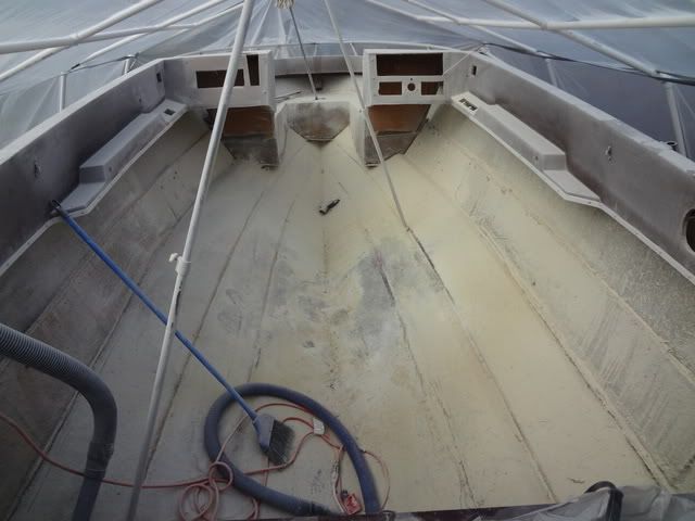

A little teaser of what is to come......
Started working about 8 am this morning. Sanding disks are lasting about an hour - 24 grit. Starting to retthink this 4.5" grinder. The Mrs. entered me in a drawing at the local HZF for a new grinder....hope it is the 7" model :)
Going along quite nicely. Used some cotton to fill the little void cross my nose for the goggles. They haven't been fogging up too bad so far. How ever, I am noticing it is quite difficult to breathe, think it is time for a new set of filters. I have looked last few ties I have been to the store but have not seen any that are the same as what came with the respirator. Guess I will have to go get a new one. Hate to spend twice the cost of filters though. The lower strap has broke on me like 4 times. I keep taping it, but it broke again, maybe I will just go ahead and grt the new respirator.
