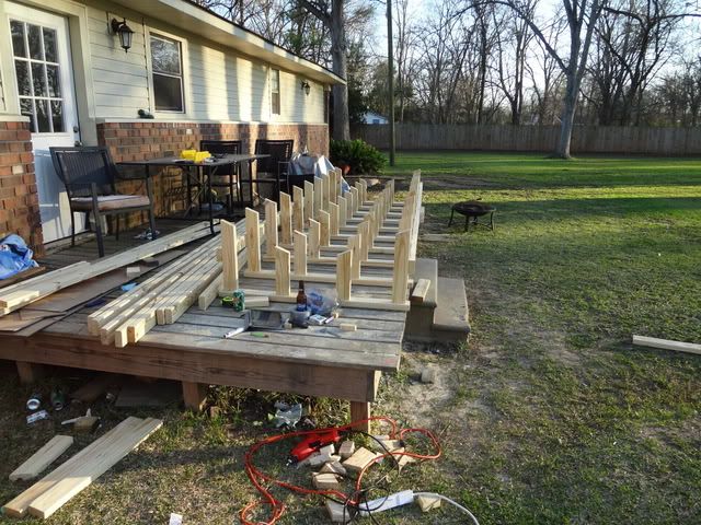

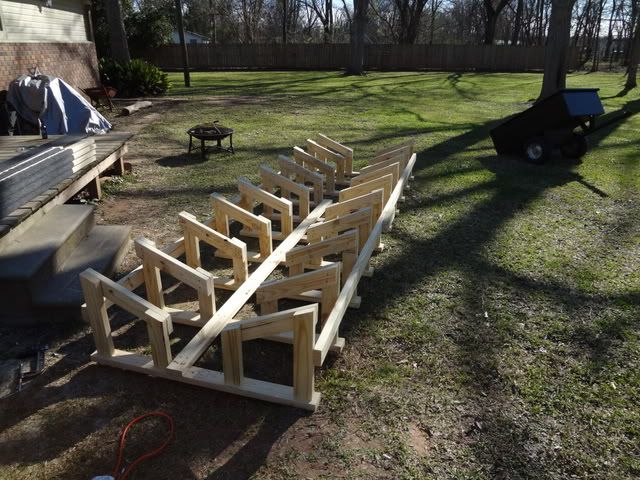

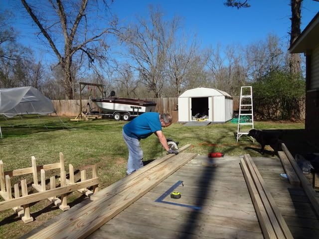

Good evening all.
My plans changed just a little today. The idea I had was to lift the rear of the boat, pull the trailer forward abit, set the bunk sections under the boat. I Started out thinking I would make 3 seperate sections to put under the boat as my temporary bunks. While I was cutting the parts out I decided 5 would be better. The I had an epiphany! I could just lift the rear of the boat with my floor jack, put the gantry up in the fron, pick the whole thing up - pull out the trailer and slide my bunks in as one piece. So Five sections turned into one giant section 13.5' long! I must not have thought this out enough, how will I move this thing when I get it finished?
Just for fun lets see how your powers of observations are.
Two types of beverages are present in this picture.
How many of each?

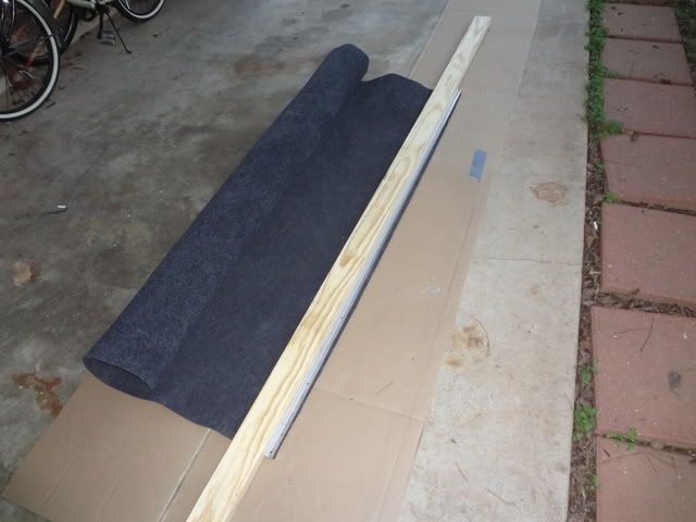

As darkness started to fall I began to focus on the carpet to go on the bunks.
I have 4 bunks 13.5' long - thats 54' linear. It takes 10" wide strips to totally enclose a 2x4.
I bought a piece of carpet at the local Lowes precut 6'x8'. So It was going to take a little figuring to see if I had enough to cover all four bunks.
6' x 12" = 72" which means I can get 7 strips that are 8 foot long. 7x8' = 56' Cutting this way will work
8' x 12" = 96" so I can get 9 strips that are 6 foot long. 9x6' = 54' This will also work, and as it turns out makes it easier to wrap the four bunks.
To be safe I decided to go with 9" wide strips. This will net me 10 each strips 8 foot long. Using a fabris wheel cutter on cardboard, works pretty good. I thought I could use that aluminum piece as a guide for the cutter, but it is too thick. Ended up using my 24" square, so it is aking a little longer to cut them out.
I hope I haven't over engineered this bunk system. The boat looks to be straight for this 13' that will lay in the bunks. After cloder observation on=f the trailer bunks, they only are supported by the ends, alowing the wood to droop in the middle if needed. Won't be getting any droop the way I have this cut out. Tomorrow I will finish wrapping the bunks. I also plant to put some cross pieces of wood to hold everything together. I will then move this close to the boat. Install the bunks. Move my gantry, lift the boat, pull the trailer out and slide in the new temp bunks .
Wish me luck!

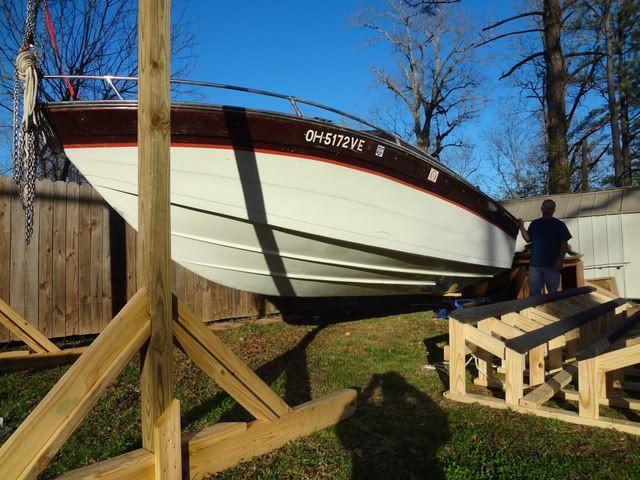

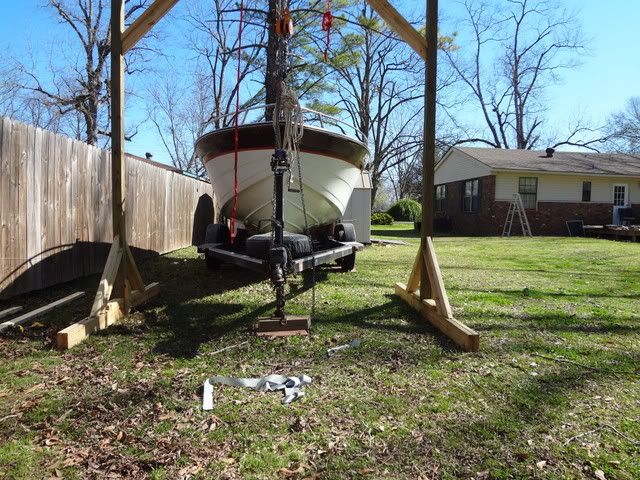

I didn't have a sling, so made one from rope.
The wife was sitting in the sun helping me today. She took this picture so you know it is me doing the work :)
Jake decided to be in the shot too.

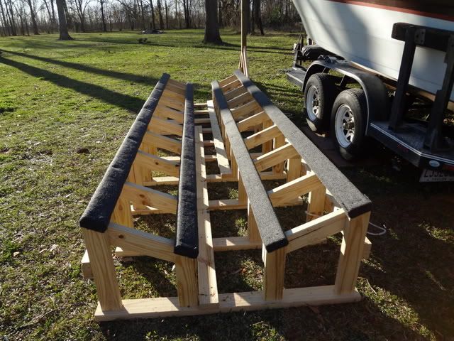

Added some bracing...almost finished. I drup it over to beside the boat to put the bunks on.
And here they are....this thing is SOLID!
My powers of the single hand levitation...lol
