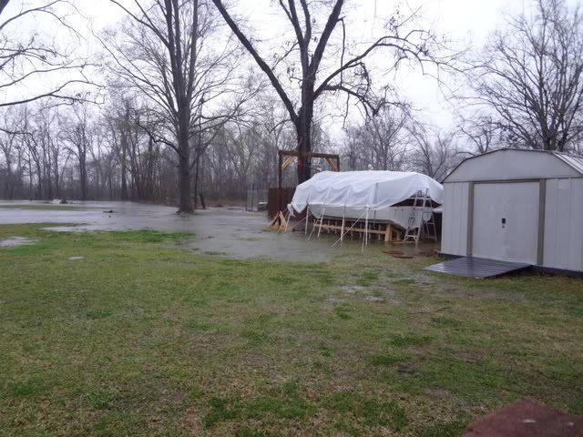

Sadly no boat work for me yesterday, today and possibly tomorrow :(
I do not want to track mud on the bare glass. The yard has looked like this for 2 days now.

Bummer dude....
Hopefully you still have a good weekend, even if you cant work on the boat!
jbcurt00
Oct 25, 2011
25,253
You better stock some rations & fresh drinking water in that bare hull w/ some paddles:eek:
GT1000000
Jul 13, 2011
4,916
Dang, by the looks of all that wet stuff, you may not have to go too far to Splash the hull...:facepalm:
Hope it dries out soon...

Thanks guys...I decided to work on figures..might be able to get some wood, glassing materials ordered soon.
sphelps
Nov 16, 2011
11,508
Ya may want to tie her up to that deck so all that grinding work don,t float away!
