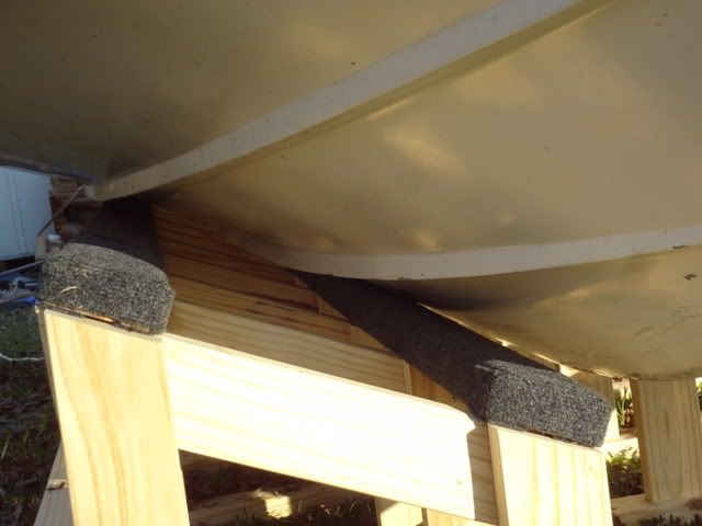

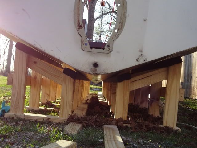

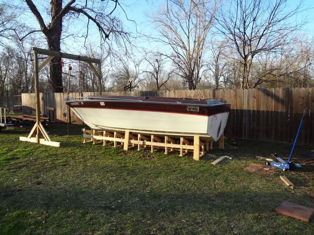

Here she is sitting on the bunks. Little gap here in the back...
Big gaps up front.
Guess I should have taken into consideration that the hull is actually cureved eh?
She rocked a little side to side, so I cut my last 2x6 to make some "stands" Not really bearing any load, just keeping things in check.

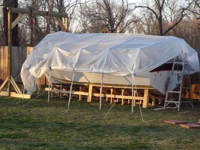

Withe the greean house back in place. I forgot to remove this before putting the gantry in fron of the boat. Decided to flip it over the boat, needless to say it did not fair well.....I tightend up the plastic so it doesn't hold water.
All in all a very productive weekend.
Now what are the thought out there? Do I need to address the bunks not touching in the fron and the little bit in back?
I should have listened to Decker83 and flipped her to make the bunks....oh well...hind sight....

It looks good to me. I don,t think it,s going anywhere.:)
I did,nt realize just how big your hull is!

I don't think I'd be overly concerned about the back too much, possibly slip a few extra layers of carpet in under the rear & on top of the bunks.
The front I'd probably cut back the outer bunk board carpet & all to near the 5th back vertical 'stud':
Then reinstall it angled up along the hull:
or in 2 separate pcs
All looks good to me though!

That cradle could support a battleship! I'm at the point of building one as well though it won't be that extravagant!

cradle looks great. As suggested I may shim it up a bit in the back, the front though I don't think I'd worry about.

Gotta agree with all before, that looks fantastic, very nice job...
I too, would maybe stuff a little extra carpet at the rear.
Only if you notice a lot of flex in the front, when you are bangin around in there, would I worry 'bout some extra support...

Plenty of support for an empty hull.
She isn't going anywhere for sure, though I may do some rework this weekend....not decided for sure.
Thanks EZ - I saw some shims at Lowes, for installing door frames. I think those will do nicely. I'd make my own if I had a bandsaw.

Man what a cradle you have built yourself. It looks really good.
As far as the gap between the hull and cradle I would check a few things out. When you put the cradle together on the porch deck everthing was nice an flat. It looks like your yard is fairly flat were the boat is setting on it but do you have any high spots in the yard there. With the 2x4 laying flat with the 4" side on the ground your cradle could have bowed alittle with high spots on the ground and all the weight of the boat pushing outward on the 2 middle bunks. You might want to check to see if any of the 2x4's or bowing from port to starboard side. You can pull a line across them and see. If they are you could shim them up from underneath between the ground and the 2x4 to see if you can remove the gap. You could also pull a line from the bow to the stearn to check if they or all in line to.

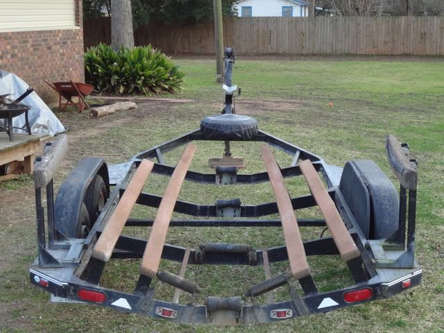

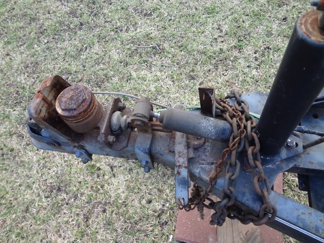

So I got a little done tonight. More measuring in the boat and got the trailer sketched out and measured too.
Wish I would have pulled the trailer out before making the "Battle Bunker" - Very informative as you can see here, the bunks on the trailer curve in as well as raise in the front.

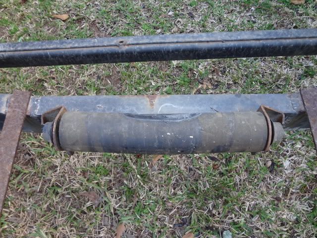

Just me or is that first set of side rollers itching to scratch and dig into the hull? I suppose they would be alright as long as you have a deep enough ramp at the lake.
This roller here was not spinning too well.
This one doesn't spin at all...hmm I wonder why?

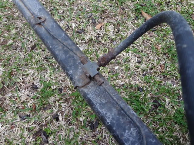

Brake cylinder is a little rusty, will have to get that cleaned up. Chains too. The mechanism to actuate the rod didn't seem to be working up to snuff....will look into that too.
Rus on the union block and line/hose fittings.
Wheel cylinder rusty, not sure what I will find on the brakes.

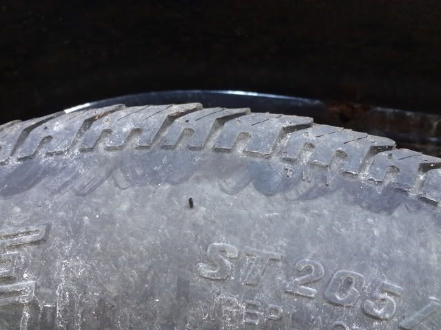

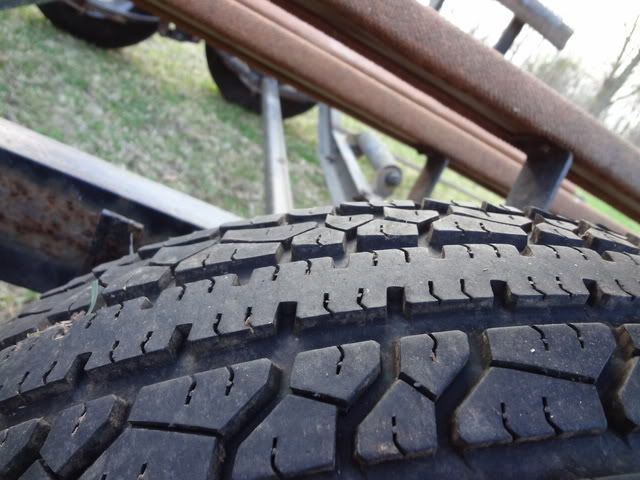

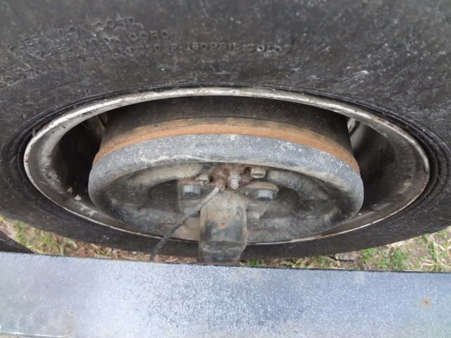

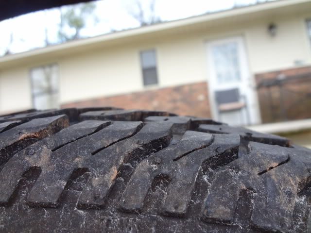

The boat/trailer took a 1000 mile trip on new tires. The tires on the axle with brakes both have feathering or cupping.
Both on the inside of tread.
Left tire, hard to see it in this pic.
Easier to see it her, this was taken from the inside looking out.
And this is the right side.
I need to remake the wheel well pieces for the inside of fenders. I would think these need to be wrapped in glass, seeing they will be in the weather. Same goes for bunks. Thoughts?
