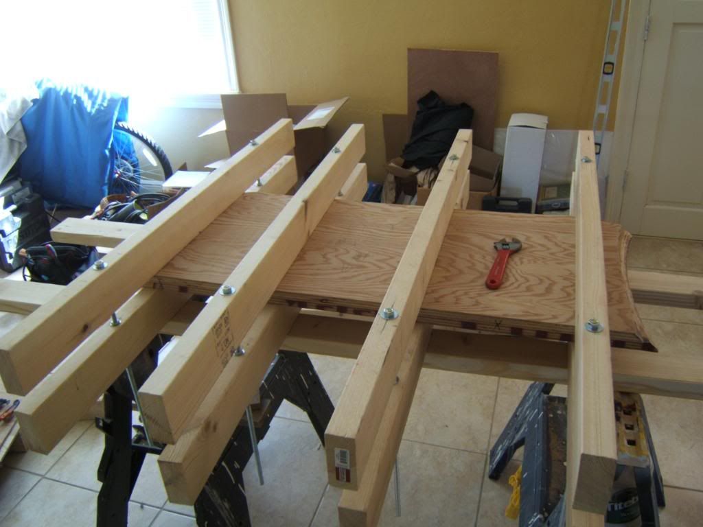

Hey folks, been a few days since my last update. I have the transom wood cut out, ready to glue it together.
Do I need to turn the pieces 90 degrees so that the facing ply is going against the grain to one another?
I will be using Titebond 3 glue, any prep needed?
I will be using screws around the perimeter where the scrap will be and on the inside where the hole for the outdrive will be.
On top of that will be boards used as clamps.

Hey folks, been a few days since my last update. I have the transom wood cut out, ready to glue it together. Do I need to turn the pieces 90 degrees so that the facing ply is going against the grain to one another? No, ply is already made that way:)
I will be using Titebond 3 glue, any prep needed? Clean & Dry:cool:
Then GT1M's clamp suggestion, w/ enough but not too much clamping pressure...W/ clamps or screws, don't ignore clamping/screwing across the center areas (esp as you mention in the keyhole) of both length & width...

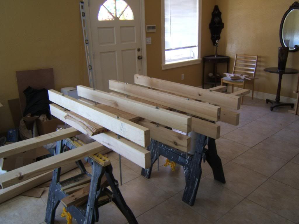

It is a done deal now...transom wood is glued.
Bit of advice for others....this wood soaks up some glue and fast. I ended up getting the wife to help spread the glue. Wish I had used a roller. I used a bondo spreader. Worked OK, but a rubber roller would have been better.

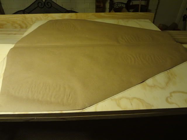

I forgot to mention how I created the template for the transom. I had bought a small (9' x 12') plastic drop thinking I would use that. I really wanted some heavy paper, you old folk know what I mean, the stuff paper bags from the grocery used to be made with it?
Well I found some at Lowes. Roll was like ~$10. Used very little, but I will use more of it when I do the deck and for carpet, if I go that route. I just lined it up across the transom, taped it in place. There was enough of an outline from the old transom that I could run my fingers along where the edge and created a crease. made it easy to cut out afterwards. Did the same around the keyhole. Used that to mark where I could safely drill one half with through holes, then used screws to button it down to second half. Worked great. Applied a couple boards and clamps to help with warping. So far, 2 hours in and no warping is evident. I will leave this as is for a day then remove.

Transom looks great! Clamps & screws look good too! Nice to have the Admiral help out:)!

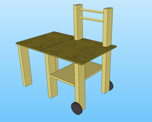

A table w/ rack at the end & 2 wheels below, lift 1 end & roll it over next to the boat. Finish up & roll it back.... 8' ply 'table' could be hinged at the 5' mark & drop the leaf down for storage/moving it around. 2X4 braces slid in/out to support the top....

Now that is a great idea. I had thought about making it foldable (the entire thing) didn't think about a drop leaf and wheels. HF here I come...in the morning :)

I just downloaded that google sketchup program, I'llsee if I can doodle up a table. I'll need 1 too, just maybe w/out the drop leaf & wheels....All else will be the same. Since I'm not wheeling mine around, I may give it a 'poly & bucket shelf.

Very crude, but I think this is close to what you were talking about.
Let me know how that glass comes, tube or not. I will be getting about the same amount, maybe a little more, haven't done a good calculation yet.

Nice cart but we need it drawn to scale with measurements . LOL

I like the Cart, especially that it has wheels...but let me jump in and say to check the center of gravity when its loaded up with all the stuff and whether it is gonna want to tip to one side...the solution would be to put the wheels under where the most weight will be when moving it...kind of like a hand truck...
Also, now you have me thinking...yeah, I know Dangerous...
The Humidity would be a huge concern for leaving the cloth/mat outside...it could become saturated overnight and really screw things up...

Excellent solution to clamping up the transom plates, that is perfect, nice work...
You are gettin pretty good with the Sketchup, nice...

Thanks GT, I agree I probably should bring the stuff inside. If you notice the paper in the first transom pick has 4 'wavy' areas. That is from some wood I had lying outside. Felt dry, but apparently wasn't.
