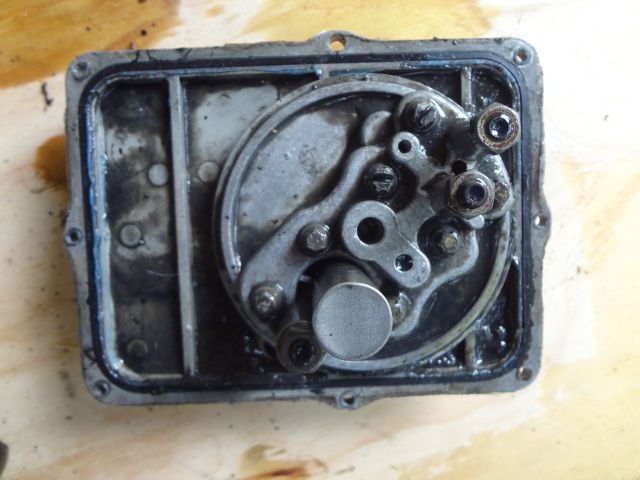

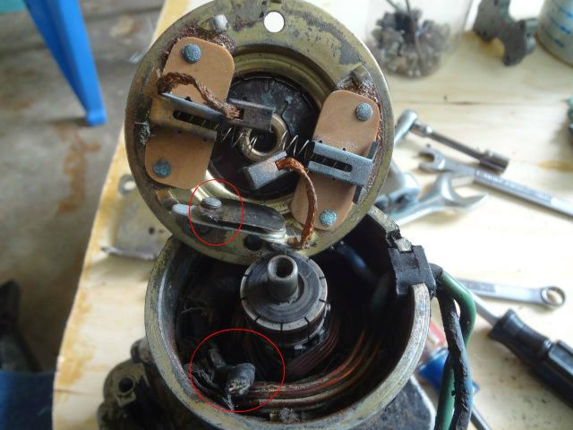

So started tearing into the Trim pump unit...took some pics before starting to assist with putting it back like it was...
Evident that it was tore into prior....someone took a chisel to two of these bolts...if it had been me I would have tried to replace them...
Wire was not soldered...see the red circles...
Guessing I might be better off to just order a replacement? I can do the work if I can find replacement parts...but the cost might be better to just get a reman?

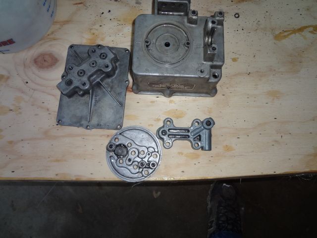

Got the trim pump all tore apart and found several issues...the wire I noted above is actually just about pulled loose from the coil...
I did get things cleaned up and ready for paint...if it doesn't rain tomorrow..like it is right now..maybe I can get a coat on these...well not all of them, some are internal :)

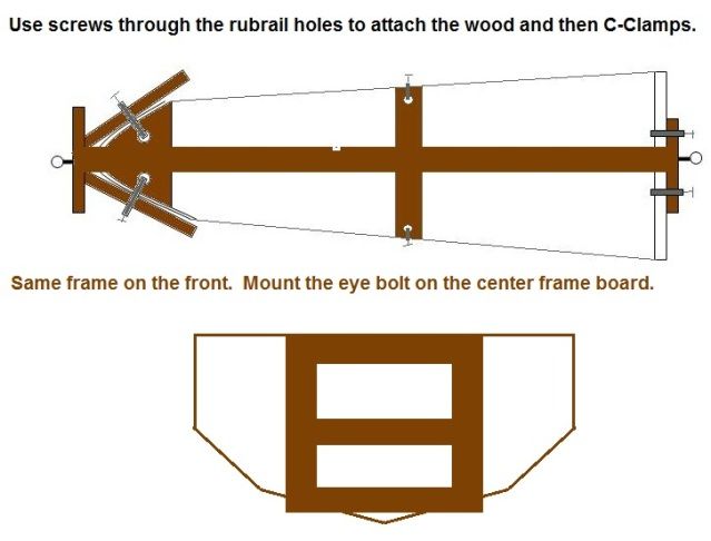

My Drawing Skills, SUCK!, but. this might give you an idea of what I am talking about. YOu can't see in the drawing but you would also run 2 boards along the bottome to connect the front and back frames.

My Drawing Skills, SUCK!.....
That is a pretty detailed drawing...Making sense now...thanks Wood! Sketch on a napkin would have worked for me...
So if I see this right...I need to go ahead and pull the cap...before flipping? I have been planning on pulling the cap so I can replace wood in it...and make it easier to run wires/conduit...
What you have on the rear there is sort of like what I had seen in those vids I mentioned...basically making a giant rotisserie...

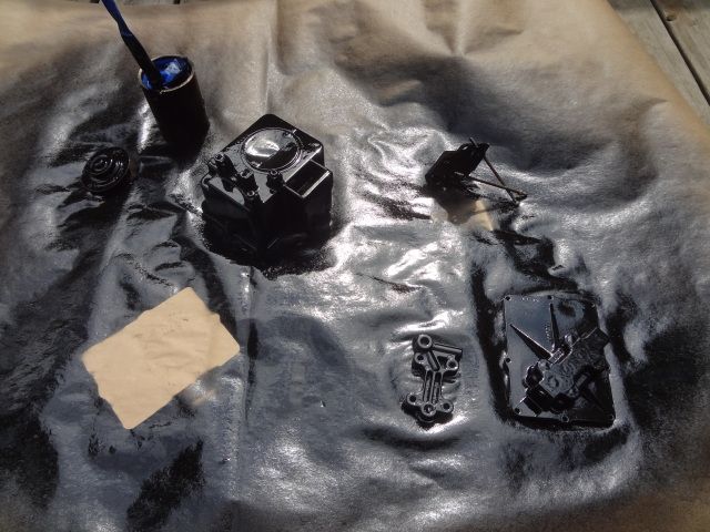

Good morning all.....
I got the trim pump parts masked and painted...waiting on them to dry before removing the tape...

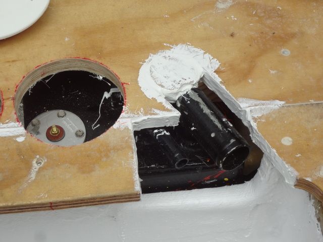

I was looking at pics early this morning trying to figure out what to do about the opening there where the tank inlets is...
Decided to put a plug with 5200 on it in there...also put 5200 on edges of ply...this may get sanded eventually...and covered with the doghouse...

When you get ready to flip the boat make sure you use some heavy duty eye bolts. I tried to use a 1/2" stainless bolt and the weight of the boat bent it before the boat even moved. I used some 2x2x1/4" angle and welded a bracket that fit the mounting bolts for the engine. I welded a peice of 1" solid round stock to the angle and put a peice of 1 1/4" pipe over the bar and welded a flat washer at the end so nothing would slip. That let me get closer to center.
Just be careful when you flip and get some help at both ends.
