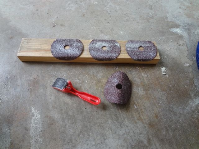

Took these tools...and went to hacking at it...

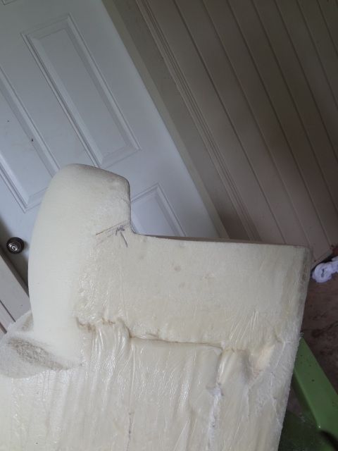

Starting to take shape....(Hi Jake)

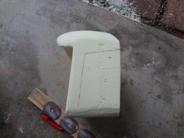

Profile...what the heck is this going to be???
More lines and angles...
This is just a rough model...may turn into a console or something...

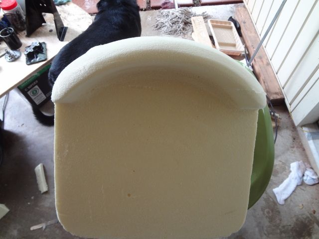

Well, it is way too tall the way it is now...not really wide enough...but think I can make that work...
Need to cut the horizontal line up to the top corner radius...then I think it might be OK....still some finessing that needs to be done...but you get the idea...

That's pretty creative Troop . Would you just glass over that ?
CaptainKickback
1,060
You going to fiberglass this to make a negative mold or will you just glass it and scrape out the foam?
