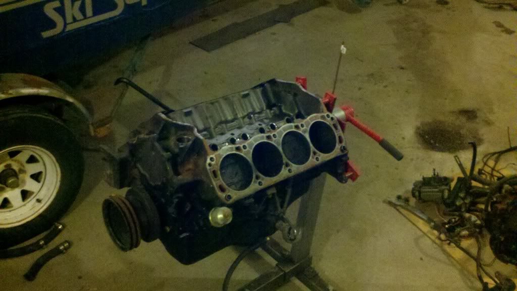

Re: 79 ski supreme

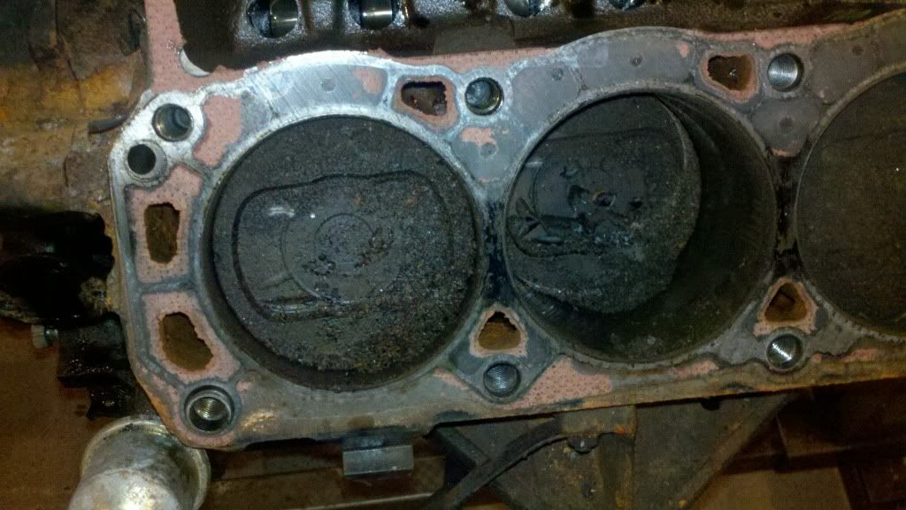

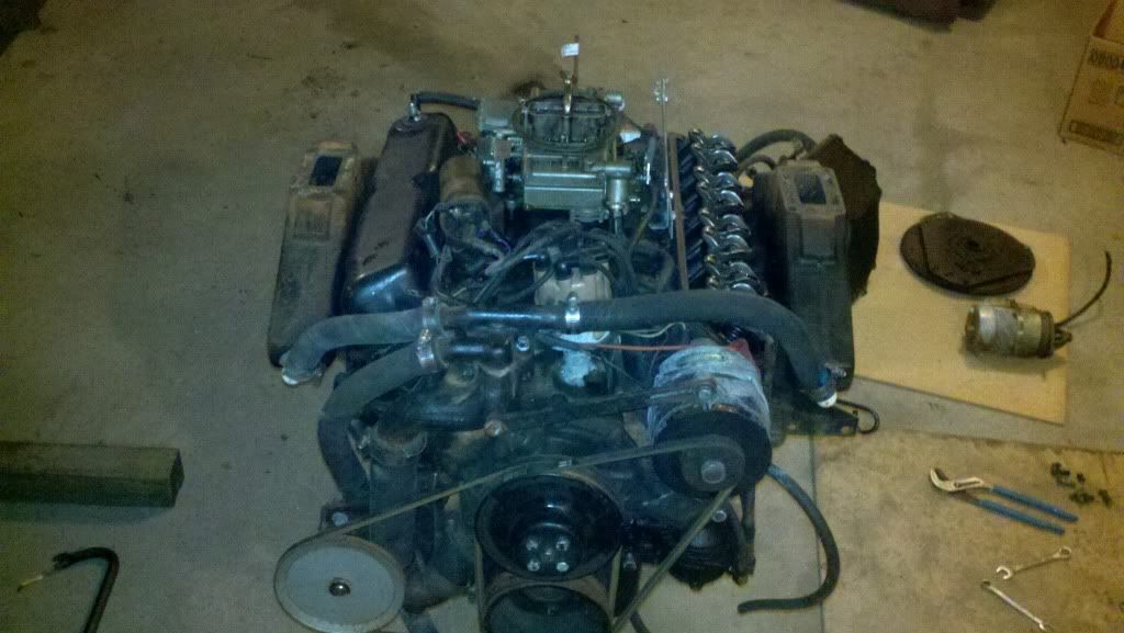

no it hasnt run yet, i just ordered the gaskets and such. i have been in a different state for the month. im going to pull the motor out and totally dissassemble it

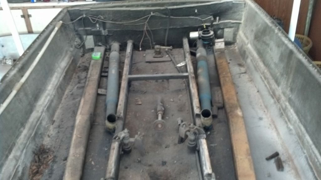

Re: 79 ski supreme

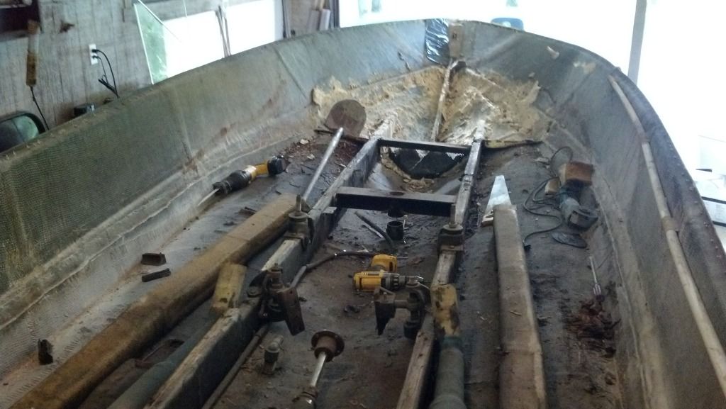

now the floor is glassed in and am wondering the best removal process. im thinking skill saw to the floor depth as close as i can get to the sides and cut the last four inches out with a grinder ?
joshkoltes
Seaman
Jul 20, 2011
64
Re: 79 ski supreme

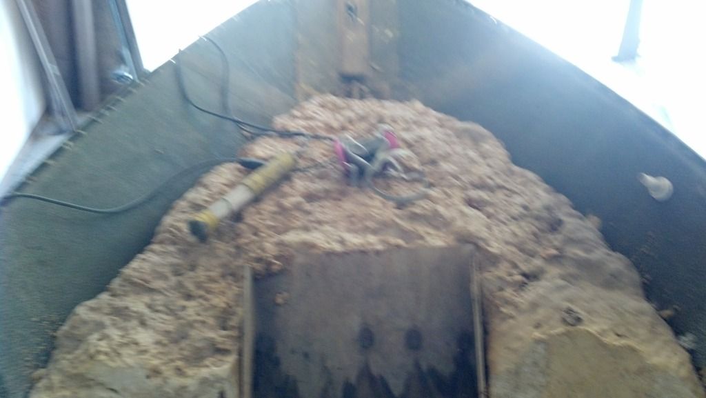

or just cut once with a cut off wheel wors real good, the floor is out but now any thoughts on how to remove the bow foam? seems to be adheared to the glass real tight.

Re: 79 ski supreme
yeah it seems like such a simple project its just two stringers and a non structural transom. only problem is this foam right now since it covers the last 1.5 ft of the stringers.
thinkin of doing a sea cast pour but was quoted 1200$ last fall for just the pour. fabric not included. wood wouldnt be all that bad either

Re: 79 ski supreme
this is where its going to sit till next month. now i can decide which route to go, wood or cast. moneys pointing towards wood but my laziness is pointing towards cast.
that foam was a real bugger to get out. good thing i did though since it was soaked and rotten.
