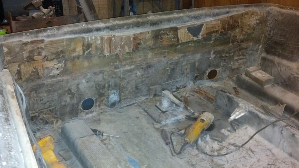

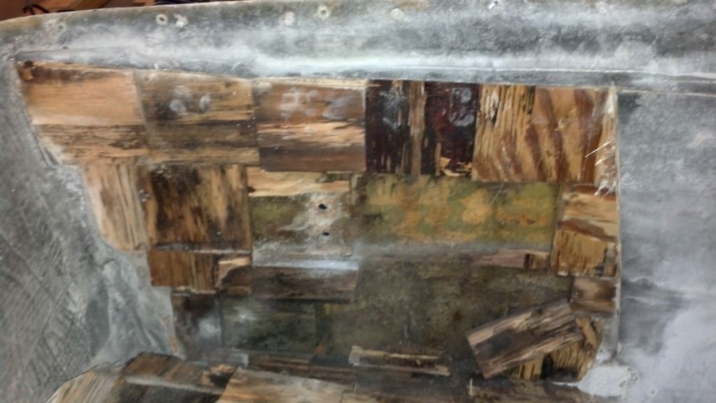

does anybody want to take this project off my hands? i dont think i can use wood with the bow of the transum? theres about a four inch difference from the middle to the edge. it is wood originally but they probably had some kind of form to flex the wood before installation?
i just need to save up for the seacast i really dont want to have anything to do with the wood work. i cant stand that stuff. im pretty sure the fiberglass guy didnt sell me enough stuff anyway allthough he really seemed to know his stuff, or at least it sounded good.
he sold me enough to tab in the new 2x6s with one layer of somthig other than what you guys all talk about not csm or 1708. he said that was overkill. and he told me not to worry about the tops of the wood being exposed? seemed kind of strange.
i should just drag it to the town dump

The curved transom isn't as difficult as you might think, but 4" is a lot of curve. If you aren't really 'into' both this boat & the rebuild of it, this project will likely only get more frustrating from here, for quite a bit. Esp if you really don't like any sort of woodworking, there is quite a bit of woodworking from now until you get the cap put back on and the interior seat boxes and doghouse installed.
If you still have the engine you pulled last year, and it's mounts, you might remount the engine if you ever got it to fire, and sell it w/ a free trailer & boat. Else it's likely to be an entirely free package, to save you the trouble of hauling it to the dump & paying to dispose of it.
It is unfortunate, but it does happen, and more often then we'd like to admit.
If you decide to dispose of it, you might consider stripping the hull of anything you might be able to sell on CL or evil-bay.
Sorry to see you throw in the towel, but you need to do what meets your needs, time frame & abilities.
