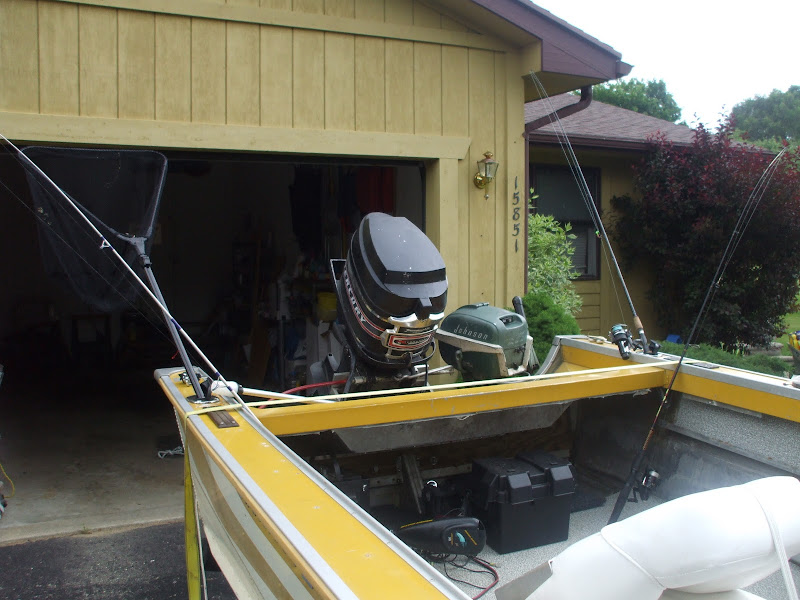

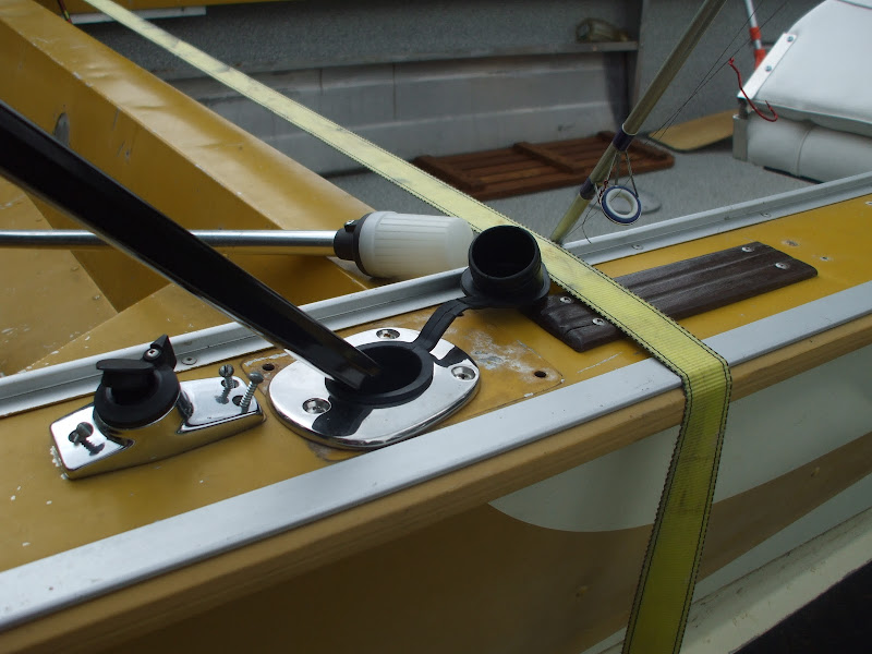

I thought I'd post some photos of the stainless steel rod holder installation. Easy job and very convenient when you're done.
I decided to put them where the old downrigger mounting bases were previously. This made it kinda tight with the 1-mile light on the starboard side but it worked out.
Drilled a whole(2.5" maybe) that would end up being the wrong shape due to the 30 degree angle of the piece. It ended up being an oval.
I placed a 2x4 under the gunwale so my hole bit would have something to bite into and hold it in the right spot to lengthen the whole.
It worked well and I didn't even bolt it down, just held it there as tight as I could while drilling.
Here it is prior to being bolted down. I'd like another 4-6 of these on the rig since they make fishing easy whether trolling or anchored. The angle keeps my lines far off to the side and away from the motors.:)

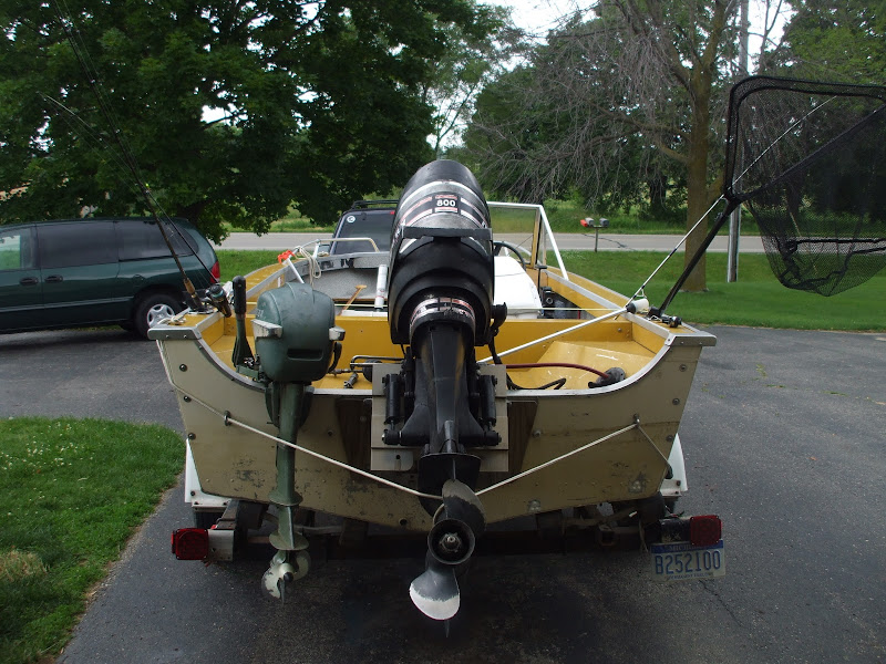

Here are some photos of the setup. It sure is nice to keep the rods off the deck and the tips up;) I need some rail-mount or flush mount for the bow next so we can keep three lines down each end of the boat.
I will be removing these and filling the holes with jb weld patches prior to painting.

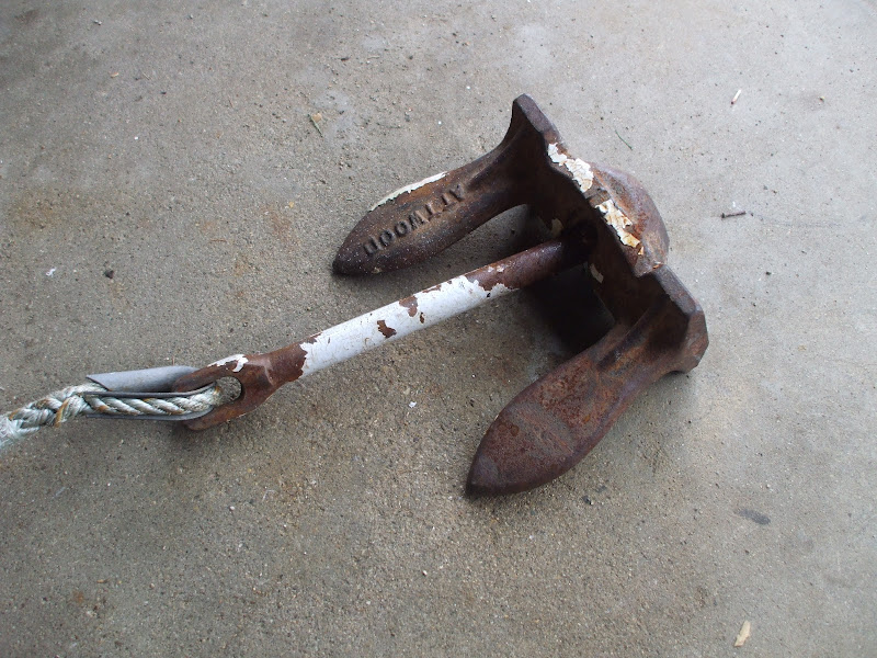

Also on the agenda is getting this rusty anchor stripped of the old white paint, primered and painted a bright color.
I'm not a huge fan of this rusty thing sitting on my brand new marine vinyl deck and leaving rust stains so it's a priority.
I have a bad history of losing anchors so I'm going to paint it yellow and keep my mask and fins on board.;)
