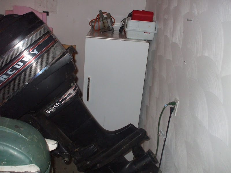

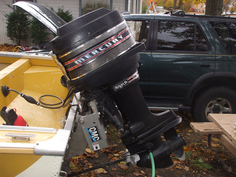

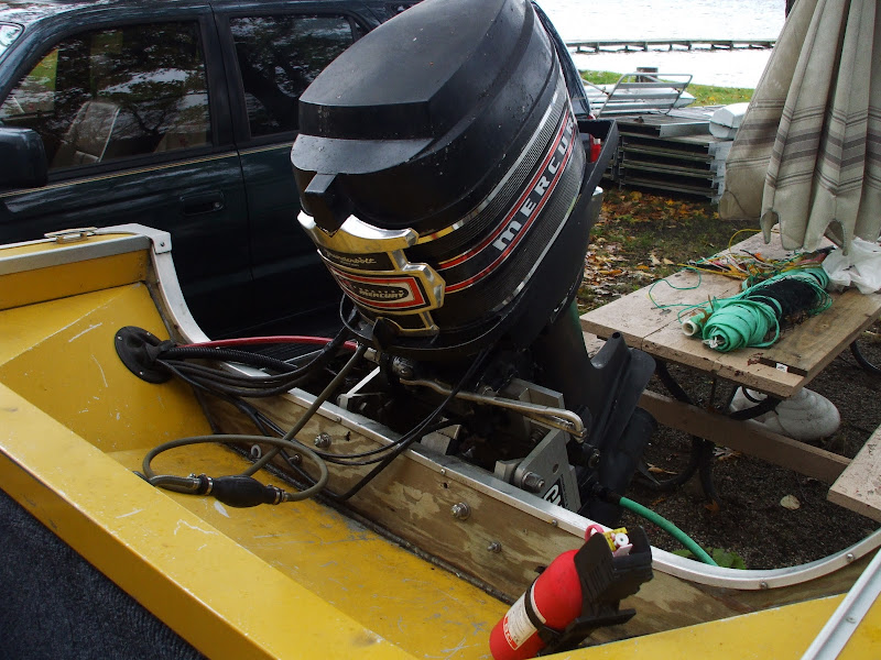

Get Merc carbs rebuilt, new plugs, impellar and other maint
Once Merc is running great---new decals and paint
