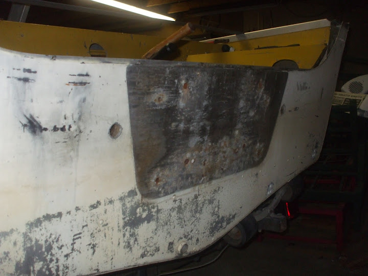

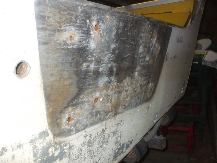

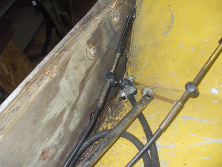

Here is the transom ready to be removed, I got rid of TONS of sillycone that somebody thought was the answer to all problems apparently.:D:confused:
A fair amount of corrosion, time to get the wire wheel going and clean things up a bit.

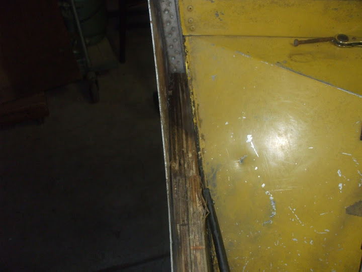

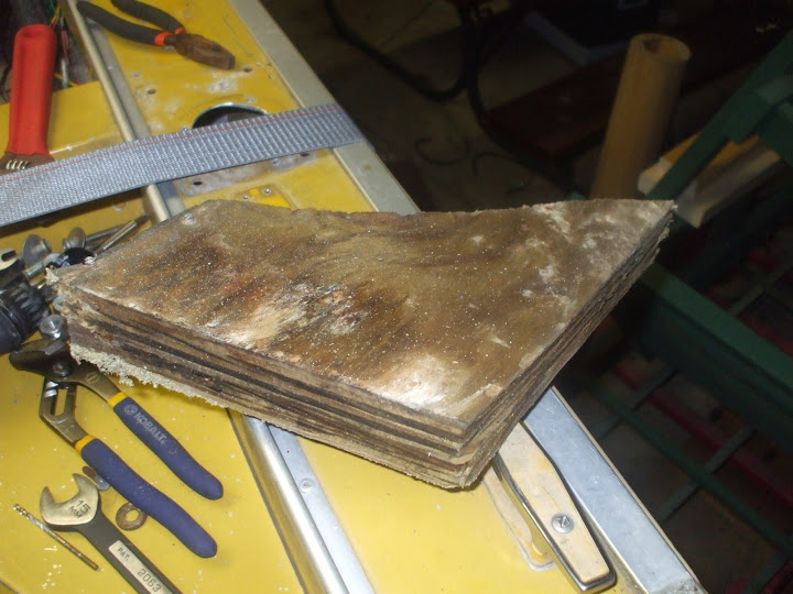

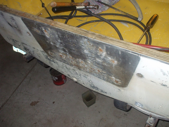

This portside corner had areas that were holding water and soft. This makes me very glad that I am replacing it with properly sealed wood.
I think I'm going to opt for marine grade and epoxy resin this time around but we'll see.
My perfect template turned out to be many pieces of wood, not even bonded together or sealed at all. The shelf life on the rig the way it was could not have been too long stored outdoors here in Michigan.
I'm looking forward to doing this correctly so it won't need to be redone anytime soon.

Hey, take a gender at that auraco ply, I am really happy with it. I ran marine grade for the Islander transom but the next project I'll go with the auraco, 1/2 the cost, great quality stuff:D

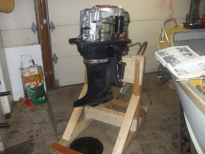

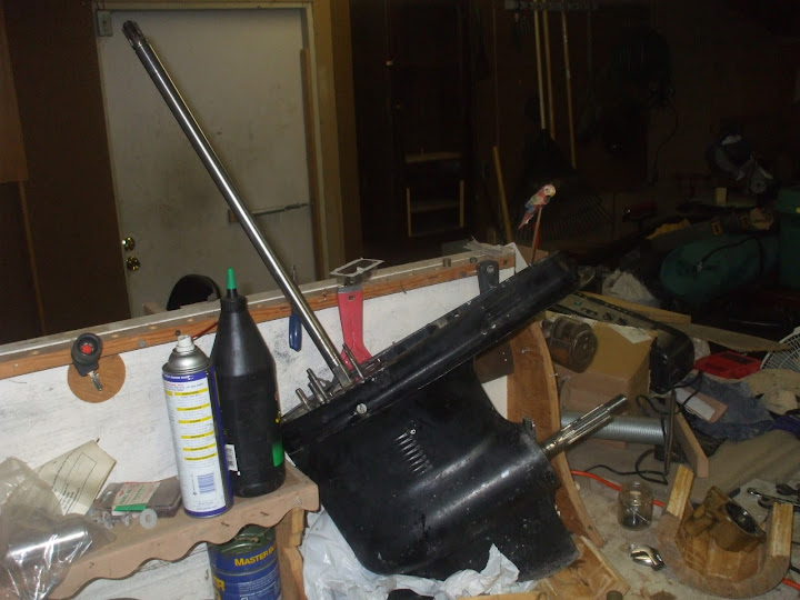

Here's the old Merc sans lower unit, you can see the manual out on the gunwale. It's a seloc that covers the basics. If the compression is good and I am keeping it I may invest in a real Merc manual.
You can see the drain pan from the lower unit lubricant. It came out bluish and clean so I'm assuming not too many gears have been eating each other up inside the works.:D
My buddy who is letting me keep the rig at his garage is also interested in working on outboards so he has lent a hand and has been reading up on the procedures.

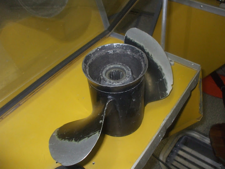

Here's the 2-blade speed prop, minus some paint and some chunks of aluminum:D
And the rest of her over on the work bench.

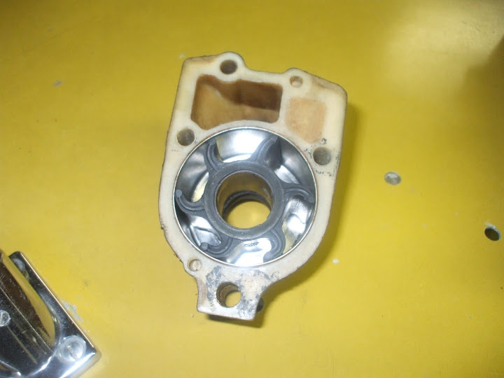

Here is the impellar, looks like it's in good shape to me. I will probably buy a new one and keep this as a spare since they are pretty cheap.

Just a couple questions...can anyone tell me if that impellar is ok even though it looks like the blades are bent a little? Probably normal but looks a little off.
Also should I be looking at getting a 3-blade prop or just get this one cleaned up at a prop shop?

Replace the impeller regardless.
Throw a post up in the prop forum and try to get an idea of what a typical prop for your boat would be (3 blade). Either look for a used one or buy one of the Solas Amita props on iboats which are <$100. Once you have your motor checked over, install a tach and take it for a WOT run to see where you are RPM wise. If you're out of your target range, buy a different prop accordingly and either sell or keep the other one for a spare (kinda pointless as the 2 blade would make a fine spare).
That's just what I'd do.

Yeah I'd like to relegate the impeller and speed prop to the spare parts bin.
Getting new gaskets, a new impeller and new spark plugs shouldn't set me back much:)

Mike, a speed prop has its place, and yours is in the spare parts bin. The impellar however is to thrown in the trash bin. DO NOT keep it for a spare 'cause you may actually use it and we don't want that. The impellar is cheap enough to get a new one. I would save the cup or reuse it if its good. As a suggestion, once you know what pitch you want, get a used SS prop. Around here we "intoduce" ours to shallows and stumps and a SS will hold up but an aluminum one may leave you stranded. A SS performs better too, no flex. Just MHO.

Gotta disagree with you on the SS prop Dale. Have you seen the places HA boats? That dude goes EVERYWHERE! I think the forgiveness of an aluminum prop is in order. May save his lower unit someday. I'd definitely stick with aluminum and carry a spare.
Agreed, much easier (cheaper) to repair an alloy prop too if it does happen to get damaged.

For the price of the impeller, I'd replace it while you have access to it. Two of those fins look too bent. I don't see cracks though, which is good. I would take your 2 blade prop and use it as a spare prop. I can't comment on the difference between aluminum and stainless because I just took my stainless off and put on a new aluminum and found no difference in performance. Although both props are the same diameter and pitch, they both pretty well perform the same.
