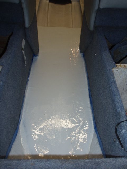

Thanks guys. I have to tell you it feels really good starting this part of the journey. I have requested two samples of Duraback (Cream and light grey) to be sent to me. I could not make up my mind on what color to get. The cream would match the outside of the boat and the grey would match the interior seats. Well after seeing how the bilge turned out I think we are going with the cream. Once all the paint is done and cured I will start with the electrics.

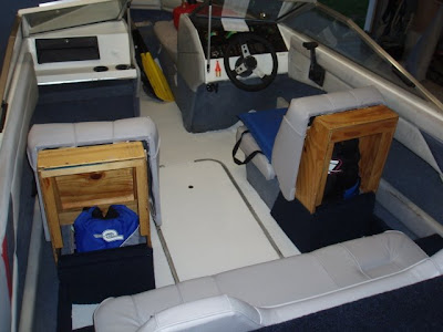

Just from my experience, I was not happy with Durabak at all. It stained tremendously easily, ripped and cut easily. I put it on my floor thinking it would be a great alternative to carpet, but it just wasn't up to the task.
I used Smooth White, it looked great for about a month:

For alternatives to carpet you could use gelcoat, epoxy garage floor coating, or has anyone considdered using spray on bedliner? I personally used carpet because I like to boat barefoot and dont like hot, hard, uncomfortable floors.

I do have a question about the elmers product that you coated the front part of the floor with, you said it was from lowes. Is it this elmers epoxy? Can you give me more details on the product if it's differnt? Thanks and keep up the great work.
