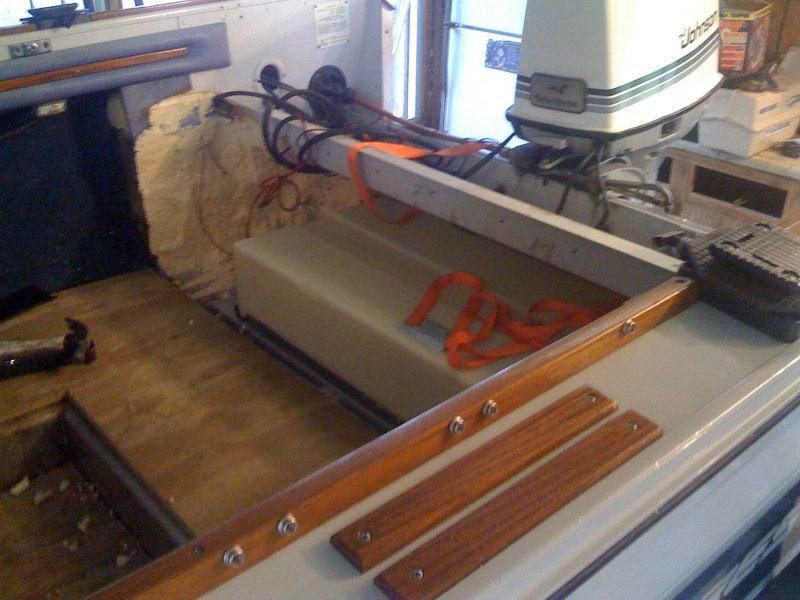

Perhaps a previous owner shellac'd 'em? Current sealer is peeling, so a little sanding should make it easier to tell what kind of wood.
Some epoxy teak 1st, then coat w/ spar varnish hoping to make regular maintenance required much less often.

Thanks for the idea. I don't mind oiling the teak that's mounted on the aluminum and the ladder. I think I might go with Spar for the pieces that are in the padding since the would be a mess to oil and would probably stain the vinyl.

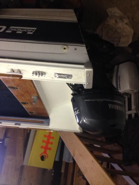

Im new here, I did some of this a couple years ago, getting ready for my new motor this spring. I added a 26 gal talk, mine didn't come with one in the floor. Sorry for the big pics (kinda blurry too), not sure yet how to add thumbnails.

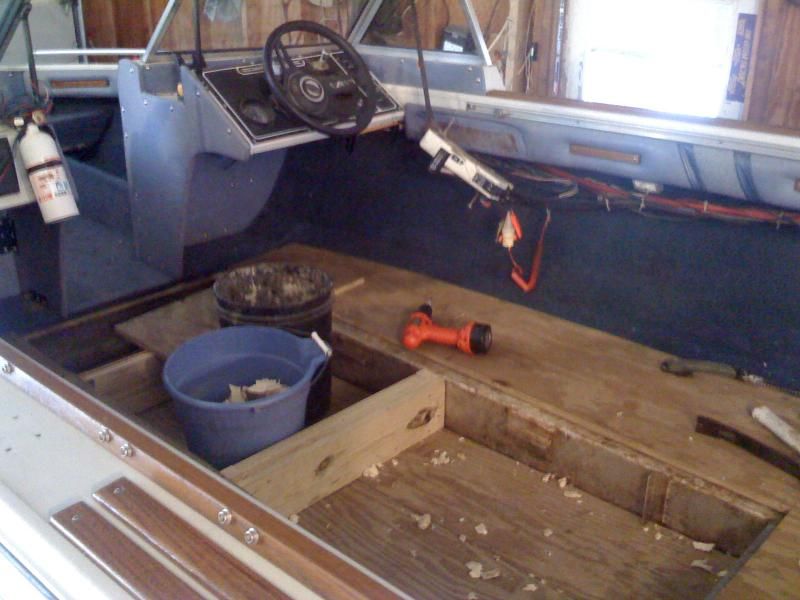

Here are a few more pics of mine. I just replaced the transom and and as the weather warms up I will be finishing the deck and removing the inboard fuel tank. I am curious how Crestliner built the area under the floor where the fuel tanks sits. I would like to convert it to a storage area. If you look back at this thread you will find more pictures of the transom replacement. The way Crestliner put these boats together it is easy to believe all the transoms will need to some day be replaced.

That's the same model/color as mine for sure. Im getting ready to put on a new Yamaha 70, my stock Johnson is pretty tired.

Make sure you use a straight edge and check the transom for any bowing. That is how I found mine was in need. When you are out of storage it would be nice to see some more detail about your below deck storage.
Also, if you go to the Crestliner website you can find a link to the catalog archives under the Owners tab to find yours.

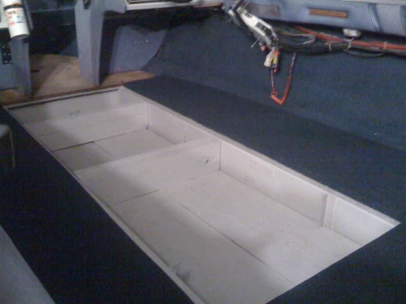

A am curious, did you reuse the original deck panel for your storage cover?

I'm guessing my boat wasn't kept in the water too much. I'm the third owner, and the guy I bought it from and me always pulled it out and trailered it home. I replaced the storage cover panels when doing the floor, same plywood. The floor was pretty spongy including the panel covers.
