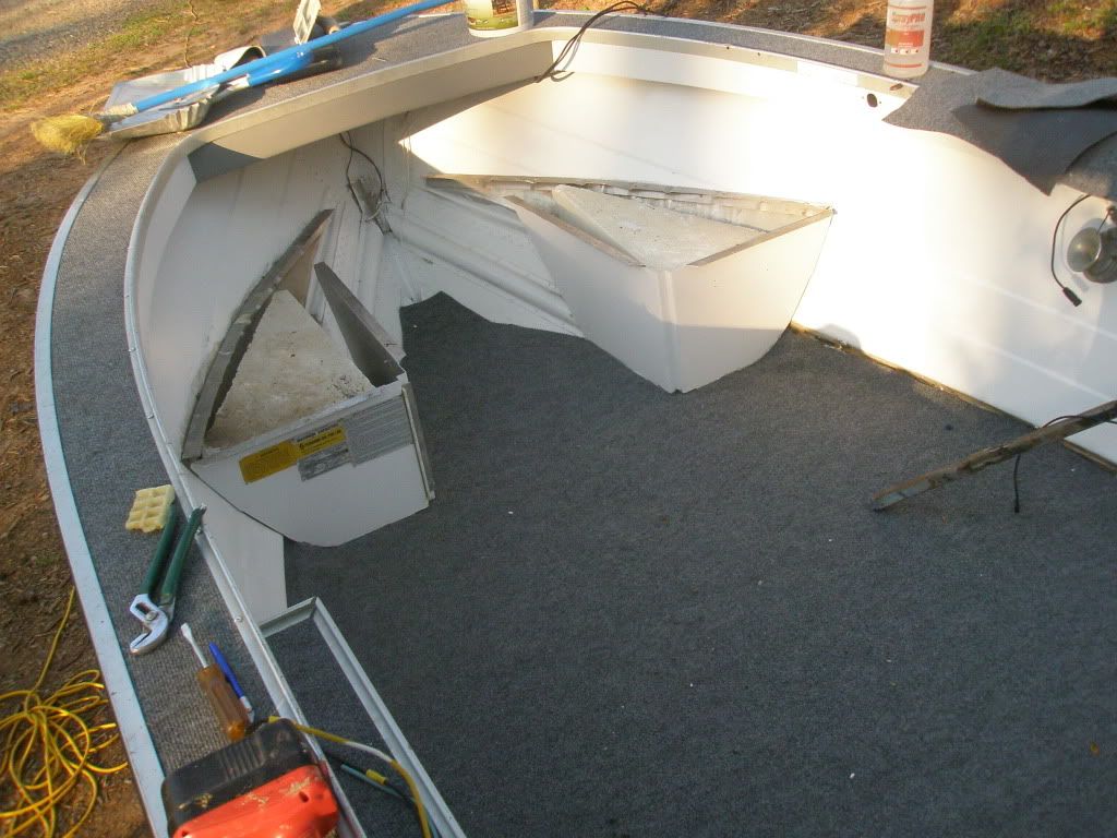

Welllll, per your recommendation I am strongly considering fastening after finishing. But here is what holds me up. In order to lift the decking, I have to take out the side irons, and gunnel boxes. The carpet (or vinyl) will be fastened to not only the floor, but also parts of the aluminum up front. You can see in the picture how that is done. I suppose it would still be easier to get the fabric off of the sides than it would be to get it off of the ENTIRE floor. I did just go through that and it was NOT fun.
sutor623
May 23, 2011
4,089
Re: '86 Aluminum Starcraft Restoration
Also Jig you can see where the holes are in the side. That is where the gunnel boxes and support rails will be riveted in.
64osby
Jul 28, 2009
6,826
So is that a piece of waffle on the gunwall?
Breakfast of Tinny re-builders.:lol:
