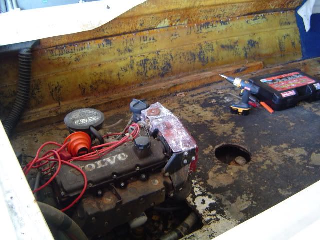

Over the weekend i rip into it removing the interior. Everything that was wood is totally deteriated. I get down to the deck and i find it glassed in. I was under the impression these were just wood. I would assume this has been redecked once before. I have a few questions at this point.
http://i1131.photobucket.com/albums/m547/snobdr1/engine.jpg
In the above picture if you look above the engine there is a rail running down the side of the boat. The drill is pointing at it also. Is this an original stringer?

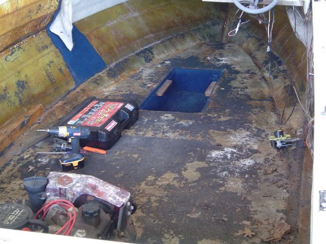

http://i1131.photobucket.com/albums/m547/snobdr1/deck.jpg
In the above picture we can see the deck into the bow or cuddy portion. I have heard of people lowering the deck to increase headroom in this area. There is a natural step in the side of the boat( runs foward from the bottom of the piece of blue carpet) Looks as if the deking would be on this step. From looking at the pic, is this the original position of the deck or has it been lowered?

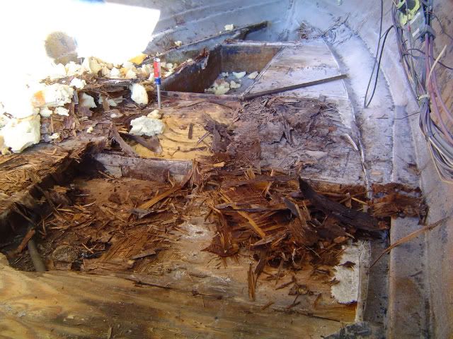

So i tear into the glass deck and im sure you guess what i find under it.
http://i1131.photobucket.com/albums/m547/snobdr1/glassremoved.jpg
Wood totally rotted. I dig some of the foam up and it is all dry except for the bottom. i find a small bit of moisture. One stringer seems solid the other has a hollow sound when hit with a hammer. All bulkheads are toast. Definately alot worse then percieved with carpet on top. What felt solit was actually where the foam was filled up to the wood sheet.
I know what im in for at this point. If this was a redeck they obviously didnt know what they were doing.
Another quick question is the VP 131a dosent seem to have any engine mounts on it. It kinda just hangs there. Is this the way they are? Mounted just at the transom?

Good motor and outdrive ;) We have had quite a few B-liner restorations here. Sad to say but what you see is typical for that era of b-liner's
Yes you have your work cut out for you and yes there are mounts under the motor.

I have heard of people lowering the deck to increase headroom in this area. There is a natural step in the side of the boat( runs foward from the bottom of the piece of blue carpet) looks as if the deking would be on this step. From looking at the pic, is this the original position of the deck or has it been lowered?
From the looks of it, I think that is the original level. I'm guessing there was the typical V birth in the bow. So that level of the deck would have been covered by the v-birth base. Got pics before the de-construction?

I didnt get any pics before the tear out. Was to excited to get started. The v birth cushions were right on top of the floor. The lever you see in the pics. After looking at some pics of the correct boat, that is the level of the floor. I will have to think about if i want to change this setup.

If you want more headroom, the recessed floor is the way to go. The existing recessed area can be rebuilt to a slightly wider version (but will have to be 2 or 3 inches higher) so there is more foot room. Then build the V-Birth bases lower, maybe only 12-14" high. That gives sitting space when the center of the v-birth is out, and gives storage compartments. The bases also are good places for batteries, spare prop, tools, etc.
