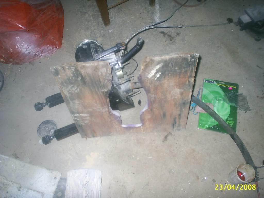

As you can tell in this photo the lower section of mine was gone. It past the drill test with good white wood. I hate to see a person fix everything but and then go back to fix the but.
Agree. At some point in time every transom will probably have to replaced. My idea is to buy myself time until I repower. Of course my plans could change.
Did you have any symptoms when running with that transom?

First time out leaked like a siv. The people who say jump on it and what ever are nuts. Mine was solid as a brick. the lower bolts were tight it just let a load of water in.
Did you try any Epoxy or some type of sealing? I guess it would be harder with an I/O since you literally have a hole in the boat that has to stay sealed.
What are your thoughts on outboard transom repair? This is what I have, Mercury 135HP where the mounting is bolted flat on the transom (not the "hanger" type mounting). What would be the symptoms of a bad transom of this type?

cracks along the corners drawn in spots near the engine mounts, black wood shavings form test holes.
