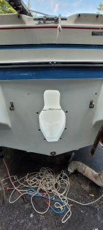

I made alot of progress today. The outside of the transom is finished as well as the engine area, seating area.
The rest will be easy lol

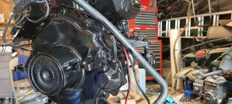

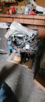

I unfortunately have to take another break from her but for a great reason this time being my youngest daughter is getting married.!
I have my lists made and am at least window shopping at the moment 🙃😅.
I want to go over the engine again since the poor thing has been collecting dust for 2 years.

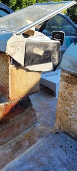

88 Capri (2022 SOTY)
Master Chief Petty Officer
Aug 25, 2019
861

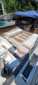

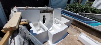

I pulled the walk through interior so I could seal the wood underneath and I'm glad I did. It will be gelcoated like everything else. I don't think there is much else I can do in this area.

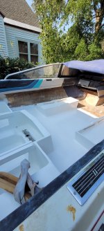

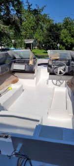

The gelcoat is finished. I touched everything under the dash that was wood related. Damn it's brilliant lol.

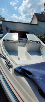

Aug 25, 2019
861

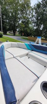

I cleaned the front upholstery and middle seats and came out better than expected. I have to work on the seat fitment with Bayliners awesome setup....um no.
Gave her a complete bath also and even the blue came out a bit.
I know may be a bit early with still needing to install the mechanicals but I've been waiting 2 years to see this!

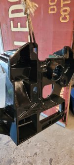

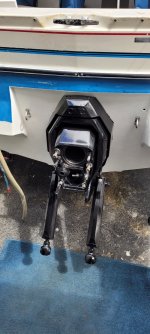

I'm starting the cleanup, painting of the outdrive components.
The transom plate came out nice and will work on the upper drive unit tomorrow.
If I can paint enough of everything I'll pretend I have an alpha unit 🤣

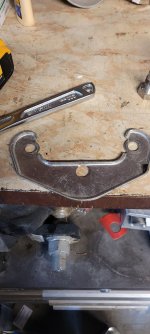

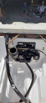

Aug 25, 2019
861

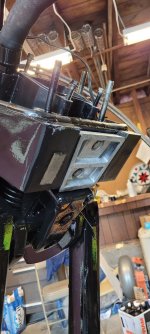

I wanted to pass along some information I learned today as far as the piece pictured.
This is located on the inside below the transom plate and if it appears bent or deformed in any way ( especially by the bolt holes) it's a sign of a rotted transom. OMC and Volvo/Penta have the but unsure of other makes.
It should be flat making contact to the transom.
Hope this may help any other new boat owners to the used boat world.
I forgot to add that mine was deformed and my transom was rotted but this part can be straightened and reused.

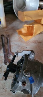

Aug 25, 2019
861

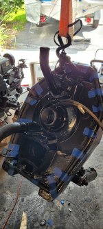

Good morning,
I attached the transom seal after a failed attempt earlier.
Because it isn't molded to the shape of the Seal area I put some sealant every couple of inches and secured it with painters tape to hold it in place while the sealant sets up enough to get it installed, I've had it setting up for 24 hrs and should be good to go. I tried once before without the tape and nothing but a big mess.
The engine is pretty much ready to go. I installed a new timing belt, inspected the wiring, plugs and wires. Still need the replace both filters and thermostat plus pick up an alignment tool.
When I had it running a couple of years ago I noticed that one of the hold down for the distributor cap had the screw stripped and after an attempt to repair it (which failed) I was fortunate enough to locate one of these NLA pieces.
Getting anxious, that light at the end of the tunnel is getting brighter!

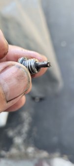

Aug 25, 2019
861
I took a picture of the engine and trim pump original bolts which were obviously steel against the new stainless replacements.
Just a comparison for anyone with an old boat that may want to check these items to see if theye may be compromised and it will tell you if you might have moisture in these areas.

That white looks great. Can you tell me what product you used? How is the finish compared to a marine paint? Thanks
Good morning Express 😊
Thank you for the compliment. I used white gelcoat and not marine paint.
I put two coats of the unwaxed down first and then one coat of the air dry gelcoat so it would cure and harden.
I must say it is extremely tough and smooth so walking on it while wet is tricky but I plan on replacing the carpet that was originally on the floor etc.
I had considered using the paint on the non-floor areas but due to budgets (if there is such a thing with boats) I decided to stick with one product.
MadProps who is a member of this site has some videos on YouTube of him using paint which might help you with your comparison.

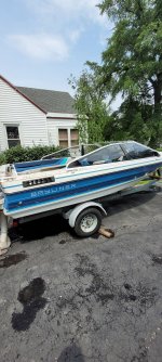

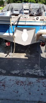

Aug 25, 2019
861

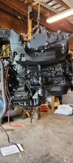

Just a little update. Transom and transom plate installed, steering connected along with the exhaust but I still need to bleed the trim system. I am hoping to get the engine set in today also, hopefully I'll have proof of that 😊

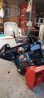

Aug 25, 2019
861
If it's black does it mean mercruiser?

Proof lol! Lots of adjustments to come.....
I'm tired time to relax 😌

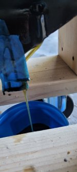

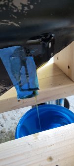

Aug 25, 2019
861
I am pleasantly surprised that I had no water mixed with the oil in the lower unit as well as not having alot of debris on the magnetic plug.
I wasn't in a hurry to drain the oil so I made a little dripper so the oil didn't run all the way down.
