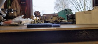

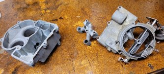

I ended up using white vinegar and only let it soak for 15 minutes. I scrubbed with a toothbrush, rinsed thourghly dried with compressed air.
I previously tried Grez-off, letting it soak for days, but it really didn't do what I had hoped. We use it at work as a parts cleaner(environmentally safe).
I'm very happy with the results and will rebuild it..🤞
Thanks everyone for your input.

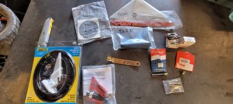

Just a little update.
I have a few of the "small" things purchased so when the weather breaks "soon I hope " I can install them to do a small test in mid-May "target anyway ".........
Power valve and piston
Air fuel mixture screws
Gas cap..... yes no joke
Control Cables
Fuel filler hose
Battery cables.....main and solenoid
I plan on getting the dwell, timing, idle and whatever else set when sitting in the water.
I'm still unsure about the carpet because I would like a taller pile. The samples I asked for 20, 24 oz. are nice but I'd like it a bit taller. The dilemma I'm in is the cost difference because whim Tod recommended is a great price but it isn't quite what I want but should I settle or spend bucco bucks........hmmmm

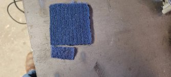

Hi all,
I made a decision on color (Jasmine), which is closer than I expected.
I always thought that the original carpet had a taller pile and heavier weight, but I couldn't believe how wrong I was as the pictures tell the story.
I decided on 24 oz. Which was a very small increase in price compared to the 20 oz.
I also wanted to mention that it seems one might need to pay attention to the direction of the carpet when going over corners because from at least what the samples demonstrated if you go the wrong way with it the rows show a gap.
I don't know if this is normal but it's something I wanted to mention.
