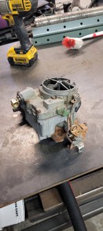

I ended up using white vinegar and only let it soak for 15 minutes. I scrubbed with a toothbrush, rinsed thourghly dried with compressed air.
I previously tried Grez-off, letting it soak for days, but it really didn't do what I had hoped. We use it at work as a parts cleaner(environmentally safe).
I'm very happy with the results and will rebuild it..🤞
Thanks everyone for your input.
Well it's rebuilt and came out better than expected and will give it some paint when it warms up.

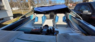

I finally have a sunny semi-warm day and got my measurements to order the carpet on Monday!
I started installing my new control cables and discovered a good thing sort of. I purchased a separate adapter kit and come to find out each cable comes with one, so I will have extras, lol.
Not all bad, extras good for hoarding, lol.

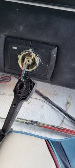

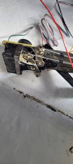

I figured out how the controller comes out, much simpler than expected. I greased all the wear points, hopefully extending its life because the plastic bushing under the lever is very worn.

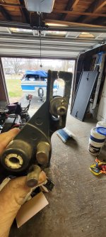

Today didn't turn out as well, as I hoped.
I was working on the shift cable that continually had play in it, so I was repeatedly trying different things and low and behold the arm broke because the nut locked up.
I used the tools at the belcrank and up by the ESA but still had play which I am thinking it's from the worn our controller plus when in gear I get alot of back and forth on the propeller which from the videos I've watched they didn't have.
I found out my anti-siphon valve was gutted.
With all of this happening, I resorted to rewiring this birdsnest of wiring for the sending unit, blower, and bilge pump.
