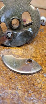

I have some great news! Upon further examination and comparison of the old and new distributor I believe that is my idle issue.
The counterweights on the old distributor are just flopping around inside and the pivot holes are completely worn and rusty.
I also noticed how crisp the new distributors counterweights react compared to the old one.
Obviously new is just new to me lol.
I wish I had a YouTube account so I could upload a video showing how bad they are.
Are these springs stretched?
