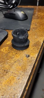

I wanted to show what can be the result of running your engine with no cooling water.
My exhaust flapper was non-existent ad this is the guide for the water tube in the lower unit.
