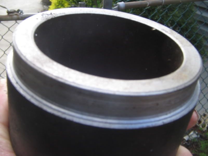

Any chance you have a picture of your plywood tool Don?

Had this machined up to install thre ring, I.D. fully supported
