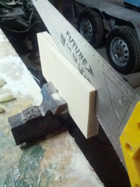

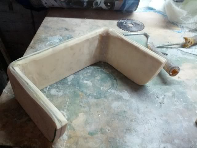

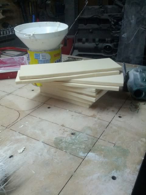

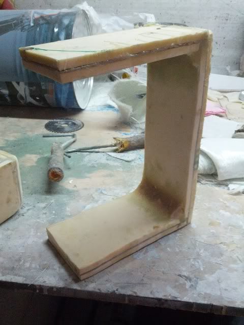

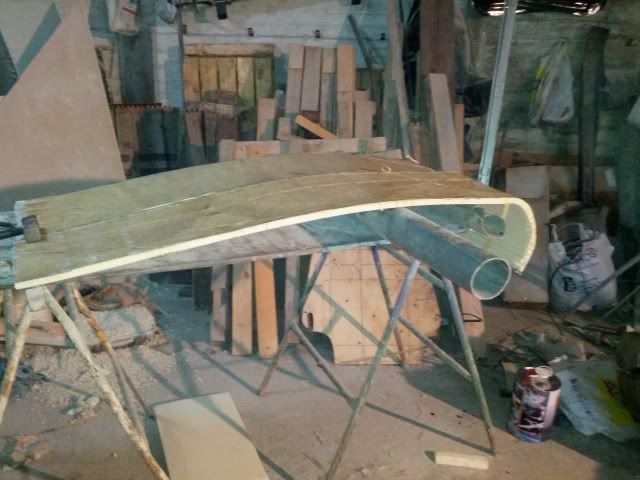

I thought I did post the pictures of the engine mounts making. Of course those mount are also made of high grade polyurethane.
I cut them half in width so I could laminate in between the two halves.
Nothing more to it.

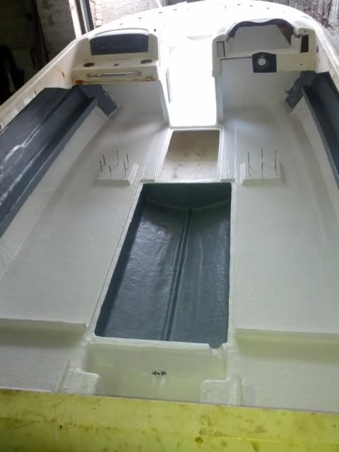

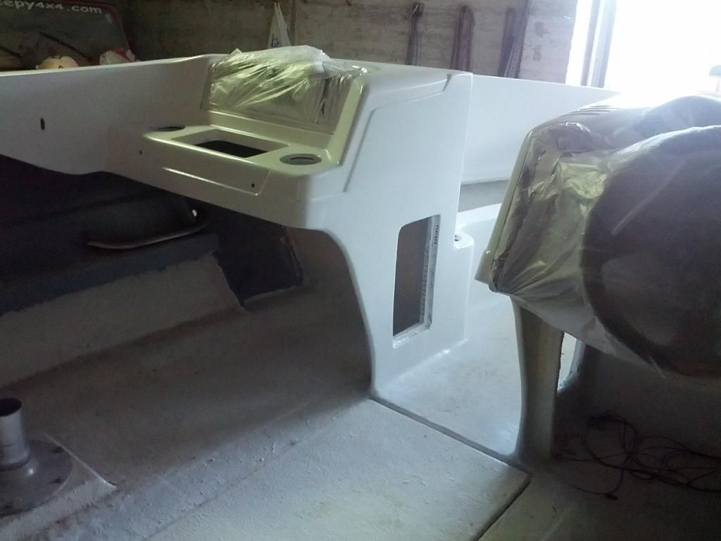

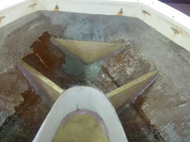

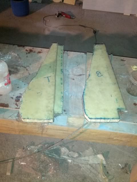

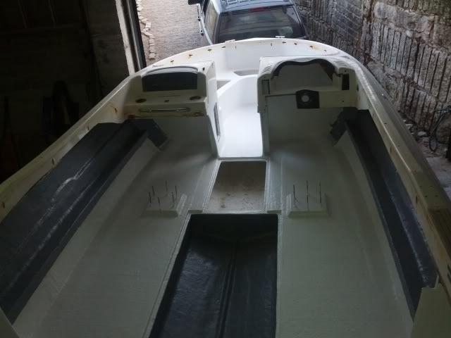

Also made the lateral molding supports and reinforcements.
I made them from honeycomb and put two end caps from waste foam that would also double as the engine bulkhead mounting points.

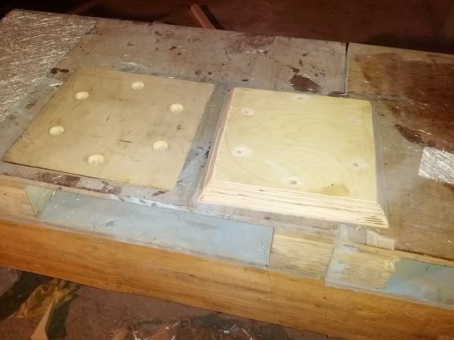

Pedestal seats supports:
Whatever you do, don't use ticks (T-Nuts). They tend to fail while screwing the seat ripping from the wood, the screw leave free turning, and you get a silly face. failed two from twelve.
And gelcoated it all IN A ROW. (What a morning).
If you see, I made a recess square hole on the two console supports so I can put doors there. But I suppose I will be better buying pvc doors than making myself.
Both console walls have tabs for screwing covers for making closed compartments.
If I could only find vinyl paint for mounting back the old moldings and protections...

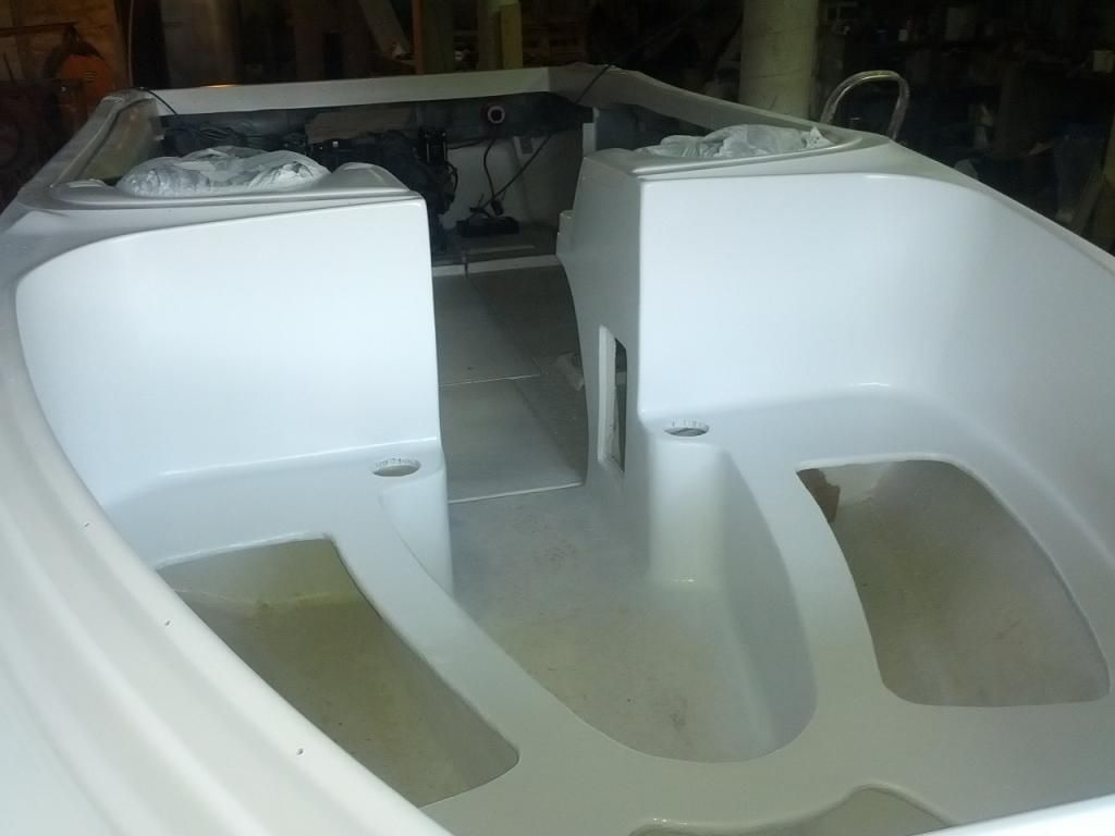

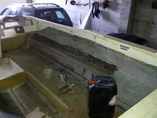

I was so deceived at the gelcoat look as it ended so rough. It took me a day or two to decide what to make with it. I thought about sanding it all flat and go for another layer. Leveling it or not previously with thickened gelcoat at the more visible areas.
But I finally left it alone for the next season with the hope of testing the boat this one.

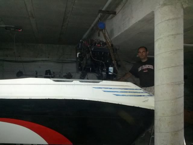

So I continued dropping in the engine:
Hi there! I'm the demon mechanic. It was so late at night when that pic was taken and I was tired and peckish at the time.
And sanding the cap. The helper still dropping a hand, but by now it's so deflated about it all. I suppose she thinks she gets more from the orchard. :joyous:
God help us if something drops starboard into that red shark at the right bottom of the pic. IT'S HERS!
I completely dropped the engine and aligned it. Connected and even made him run, but the problem arise when I dropped the original vessel harness. The wires are so rusted that for every system I connect I get so much gremlins that take so long to fix. I'm trying to make work the more healthy sections and will be replacing the remaining.
Basically the damaged areas are those related to the console. Trim drive, gauges... the engine drive (key cables) it's also affected but it's own harness is good.

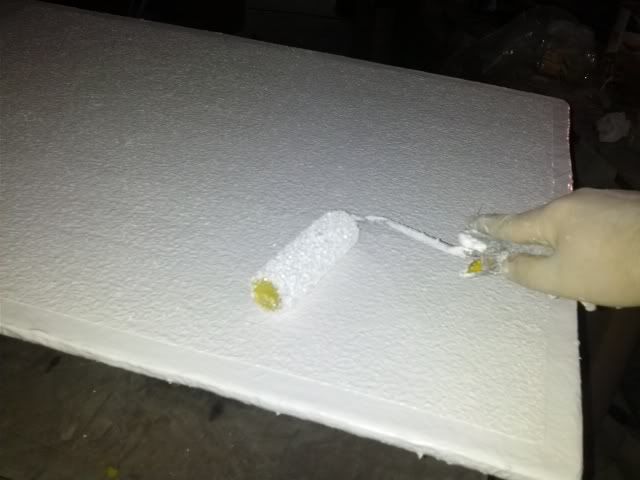

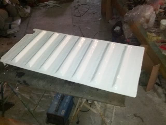

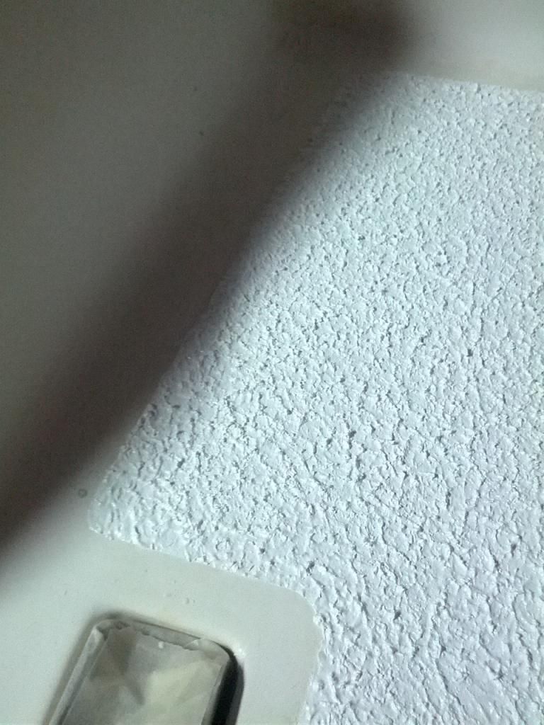

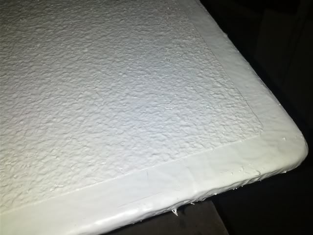

Been working on the ski locker and gas tank covers. I found that a texturized paint roller is a fast and acceptable solution for no-slip surfaces.
There are the pics for the gas tank cover. I added ribs from PU on the underside for more rigidness:
*Please take into account that on that last image, the border wasn't already sanded.
I laid the gelcoat in two layers. The second one for the no-slip area. That coat was laid with the normal roller, and then when the gel was almost cured I user the texturized with fast passes.
If you try it before the gel started to cure, the roler will clog and the surface will be un-even.
Someone told me about using coarse (?) salt. Laying it on to of the gel and wiping it with water after it completely cured. But I was concerned about it affecting the gelcoat.
I think that method it's more suited for paints.

Basically I re-done all the no-slip surfaces using a roller while teh gelcoat cured. And then sanded it until the surface was soft and nice to bare feet.
There's a sample before sanding.

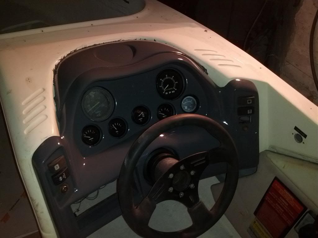

That's a picture of the contro, panel restoration before painting the interiors:

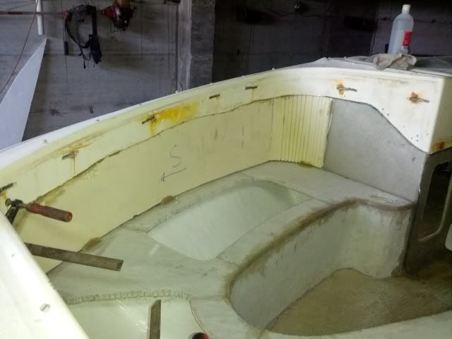

Then I painted with poliurethane all the newly built surfaces. That's a picture of how the bow ended. I'm very proud of it.
The edges of the seats don't deflect a bit. I can stand still on those edges without it deflecting.
This is a detail of how I modified the consoles feets to be more modern. Those ugly tabs that you can see on the interior are to bolt a covering panel, so the space under the consoles become two lockers.
I initially thought about making a custom doors on the sides, but the pvc doors on ebay are so available that I will order a pair of them and bolt in place. I was having hard times moulding the recesses for the doors.
