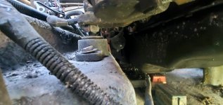

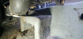

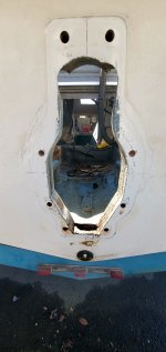

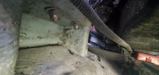

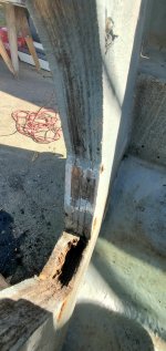

Starting tear down today. I got a boat that must have had the engine installed on a Friday because none of the dang holes they drilled were staight.

They drilled with the engine in place. Not enough room to drill straight down with a manifold on a normal drill. (Right angle will squeak in)
53,041
As stated above nearly every boat has the bolts drilled in at an angle

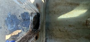

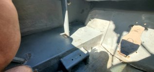

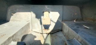

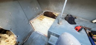

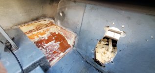

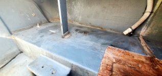

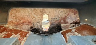

I have the engine out. I don't have a moisture meter, so I've just been checking for rot with the drill. If I ever do buy another boat a moisture meter would be a good investment because there are so many places that were inaccessible with a pick and hammer that I missed when inspecting the boat. I did find more rot in the bilge area though when everything was cleared out.

Since I'm going to replace the stringers and transom now; would it be better to start a new thread?

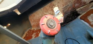

Made a good bit of progress this weekend. I'm down to grinding out the plywood. I picked up a wood carving disc at harbor freight and it's been working pretty well; even grinding out the staples in the wood. I cut back the deck and stringers about 16" to give me clearance to glass in the new transom. Once the transom is complete I'll move on to the stringers and do one side at a time.

That wheel is death trap (only thing that hurt me doing my resto)I used 2 cutting mine to a shell. :p Rips down a lip flat and cuts out ply nearly instantly.
One time I placed it down before it stopped and it bit me. The other it kicked. Neither was deep but it was a reminder. Grinders are to be respected.
The coarse carbide carving disc is extremely effective compared to going through flap discs too.
