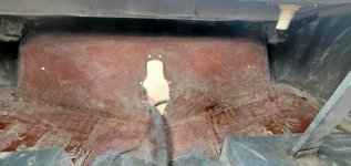

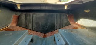

In my situation I'd prefer to leave the cap on and mask off areas where I won't be working. The boat is outside and the cap gives me some protection from the sun. I can also store my tools in the bow when I'm done for the day. I'm almost done grinding out the wood in the transom; the wood carving disc and 40 grit flap wheel worked great! I'm going to pick up a sheet of 1/2 & 3/4 inch Coosa Bluewater 26 to glue to the transom skin.

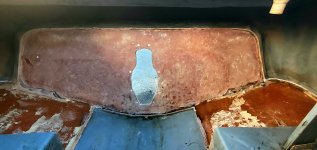

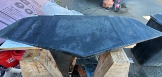

I finished grinding the transom and the areas I will be tabbing to. The skin on my transom is thicker on the bottom than it is at the top (3/16" on top and 1/4" on the bottom). I believe the reason behind this is because there is a layer of woven roving running a quarter way up the transom from the hull bottom. Sea Ray filled the gap with chopped strand. I'll lay in some 1708 to build the transom skin back up to 1/4". I also finished bonding the new transom core together last night, using epoxy mixed with milled glass fiber and a litte cabosil. I did a couple things different from the original design of the transom. Instead of starting the core just above the drain it will now be starting at the hull bottom below the drain, and the steps in the core are now a gradual taper between the layers. I doubt it will make any difference but in practice it's a better way to distribute stress.

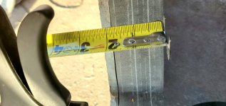

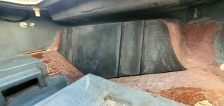

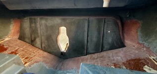

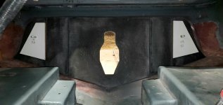

Here's the fit check. A little more trimming at the corner is needed but, I'm happy with the way its turning out so far. I'll rough out the key hole next.

Drivewayboater2
Aug 21, 2019
396
Just stumbled on to your thread.
Looks great. Make sure you’re in spec with your transom thickness.

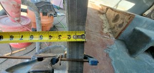

I'm already at 2 1/8" without glass and the core not bonded, that only gives me a 1/8 of an inch to work with. I'm cutting it close. I might run the belt sander across the transom a few times to give me some wiggle room.

tpenfield
Jul 18, 2011
19,646
Do the 'burn an inch' technique to get a more exact measurement, but generally you want the core to have been 1.5" . . . looks like you are at 1.75"

I mentioned before that the tansom skin was thicker at the bottom half of the key hole. I used the belt sander with 36 grit and brought the skin down to 1/4 inch all the way around the key hole. There seemed to be a large buildup of CSM around that area. A straight edge would rock across the hole, and now its fairly flat after sanding. I figure with the stack up I have planned it will be 1/4" for outer skin, 1/8" for glue, 1 3/4" for core, and 1/8" for inside skin. If it all goes to plan it the transom will end up at 2 and 1/4" thick.

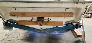

Well, I've decided to use thickened epoxy to bed the transom. The bad part is, I will have to baby sit the job with a rag and acetone to clean up the squish out. The reason I'm cleaning it out is because I want to fillet and lay glass with vinyl ester resin. I am working on the clamping setup setup now so I'm not fumbling around while the epoxy is curing. This is a picture of my setup. I did not drill any new holes through the transom.

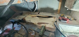

The transom core is now bonded to the boat. I mixed up about 6 quarts of thickened epoxy resin to spread it on. I ended up throwing away almost 4 quarts of the stuff that squished out; kind of overestimated on my part. Starting work on the port side stringers now. I would like to add more fuel capacity to the boat by building a couple of saddle tanks to fit in between the stringers where the floatation foam sits. My concern is though, without the foam the fiberglass will flex a bit more between the stringers.

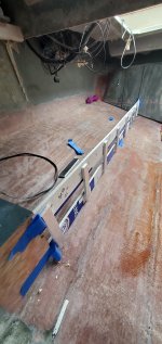

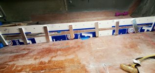

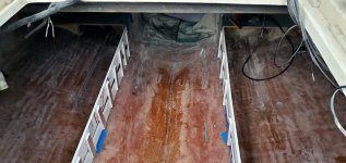

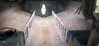

Here are the 2 main stringers patterned. I used 1/2 inch Styrofoam board. I cut the Styrofoam into 2 strips for each stringer. The top strip follows the plane of the deck and the bottom strip follows the plane of the hull. Then I just used bits of Styrofoam hot glued in the center to hold it in place. It's a really close fit as is, so I'll probably shave an 1/8" off the top to give me some room for bedding.

Interesting approach. What is the height difference front-2-back ?
